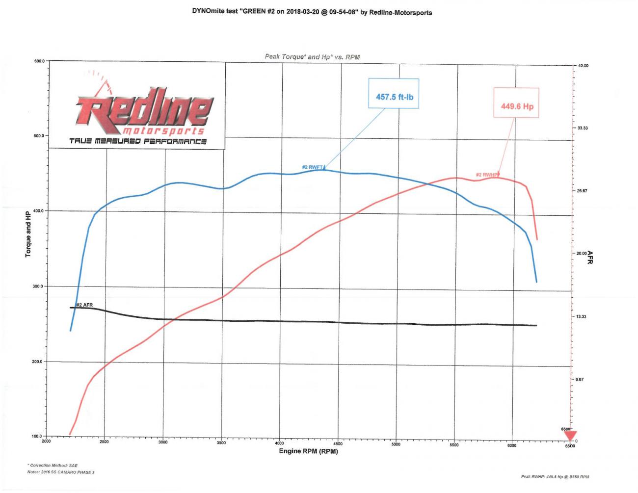

Hey guys, so I ended up getting a dyno tune at Redline Motorsports. I only have a CAI Intake, ARH Headers with H Pipe, connected to Borla Atak Axelback exhaust. The results are 449.6 HP and 457.5 TQ. Not bad and a good starting point.

Seems like a Happy Dyno
Good to see though

Looks good. Did you baseline on the same dyno stock? That's the most important thing when going on a dyno.

No, no baseline, I did all that with my 5th gen back in the day, didn't really care too much and didn't want to spend the money. After I install the cam I will get another tune going. I am going for a bit more aggressiveness on this one. The last camaro I was fairly mild with the exhaust and cam but ended up reaching 507 NA.

Those are excellent numbers. Help me remember AFR... Can't we get to just under 12 and be OK ��? Been qwhile...or is it 13.5?

I think anything over 13.5 starts getting dangerous no?

Since this car is naturally aspirated, the tuner was probably looking for around 13.0:1 AFR at wide open throttle.
The 'just under 12' was for an older-design, port-injected motor with a supercharger or turbocharger. That would be richer than desired for naturally aspirated.

Dam those are some strong numbers, congrats. What cam are you going with cause I'm getting ready to mine as well
