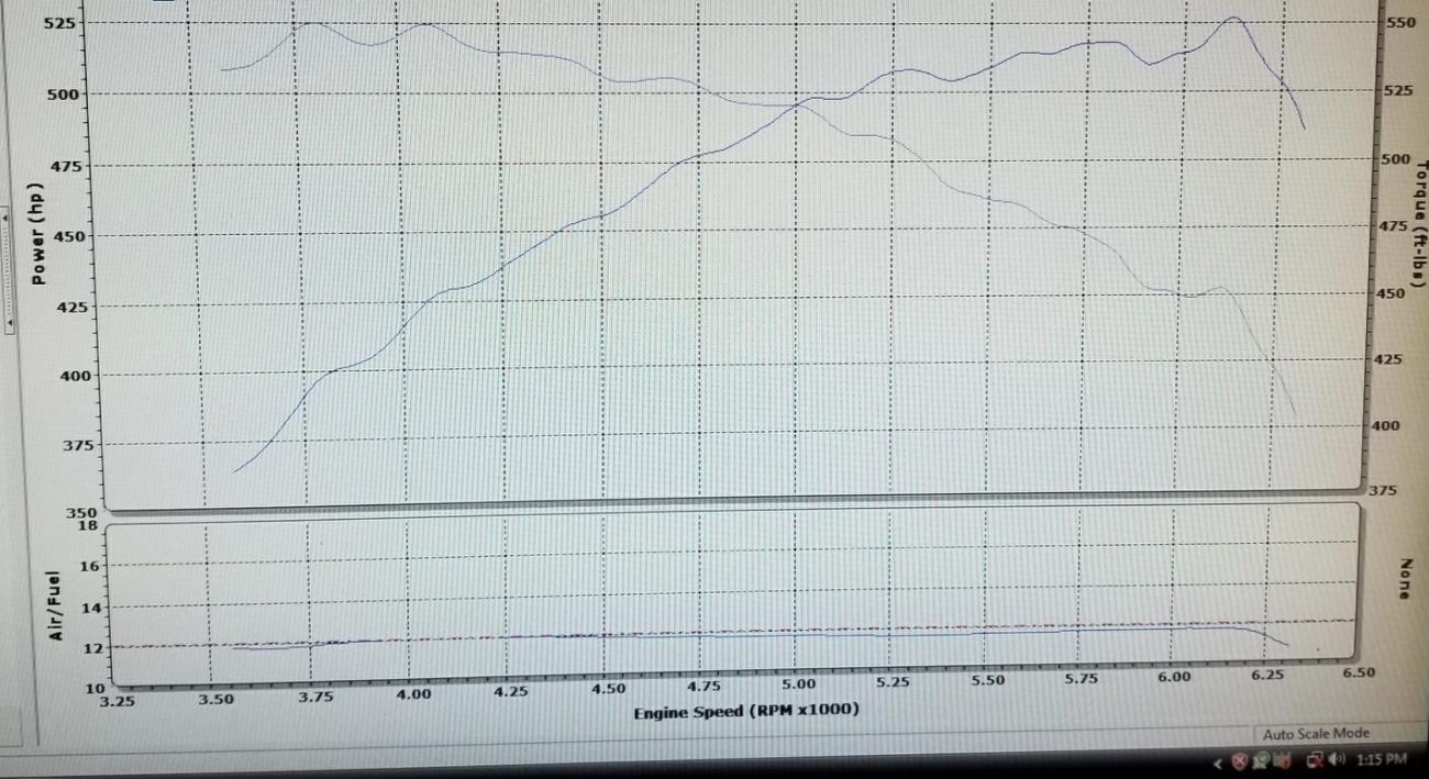

Good stuff 5-6psi and a really conservative tune. 527rwhp 550rwtq.
With the 98mm pulley...I will order the 95mm pulley this week. On the street, this will be so much fun...can’t wait.

Russ is right we needed the 95 mm pulley to get to our goal. He will get it ordered this week and that should add about 1.5 lbs of boost and put him about 545-550 rwhp and 560 rwt. Fuel was a little rich but the tune was actually set up for a 95 mm pulley so when we get the pulley installed I think it will be a pretty nasty Vert and hard to handle for most cars on the street in the Gateway area. I know Russ has more planned for later in the year so watch out for the Drsagacity 2ss in the Stl area. We will get it to the track soon also and see what it will do on street tires. I think it will be pretty respectable for sure. I'll get some graphs posted later

Here you go...

This car drives like stock, it got 25 mpg going to and from the dyno. Can't beat that in my opinion. Boost levels are very safe, with the 95 mm pulley change you'll be 7 1/2 to 8 lbs max with about 11.8 to 12.0 on the AFR. We saw 6.5 to 7 lbs on all 3 pulls. Mine was about 700 rwhp at 14-15 lbs. Who's do you think is safer?
