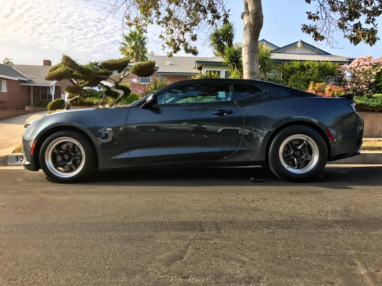

Getting my car back this week from the shop can’t wait to test it!! Mods are msd, e85, rotofab intake, nitrous outlet 90mm plate system, custom fabricated standalone fuel system for nitrous, 10 lb nitrous bottle with a nano, kooks 1 7/8 catless headers, spark plugs I’m running are denso ITV24 2 step colder, I’m running a nx maximizer 5 progressive controller, it is on a 175 fuel jet because I’m using the nano and 150 nitrous jet. It should be somewhere around 660-680 whp I will keep you guys updated

That car looks sick as hell!
