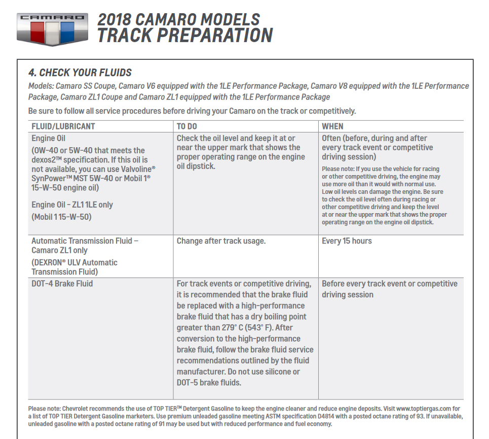

Here you go.
Name:  2018 Camaro Track Prep Guide.jpg

Originally Posted by JusticePete View Post
Damn.... that must be a newer performance owners manual insert. I don't have one that states all that, but assuming the same principal. Good info here.
But yes, I wanted something that the owners manual states and seen another thread that used the Motul oil. While that may work. I'm really anal.

Originally Posted by oneredry View Post
From what I understand from other threads similar, Dexos 2 is 2 parts, one being more for European engines and/or Diesels. This is what I meant by finding the right specifications here. Seems like no one (outside what you just found as I found the same thing) has them. Hence why my second and third options according to the 2016 owners manual. But if the mobil1 15W-50 is what I can use (again its different between the years, but same engine) I'd love that.
We run either 0/40 euro spec Mobil1 or 15/50 Mobil1 in the cars we prep for VIR. GM says 15/50 of the LS7 and such so why not for other GM engines.
Note: the 0/40 goes in race motors and most Porsche cars.
