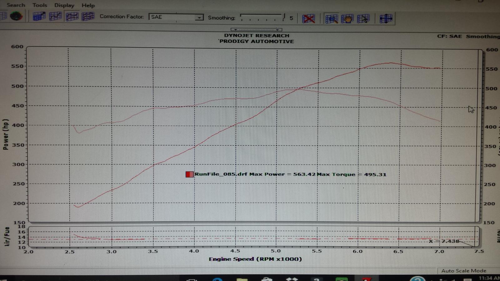

These are two different cams in 5th gear. The top is my STG 2 on a healthy motor. The bottom is the STG three cam but my motor is not healthy. It will be soon though.
