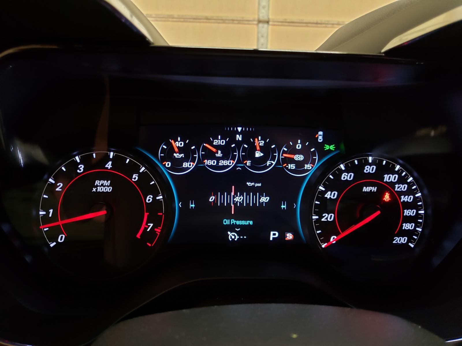

What oil pressure are you getting?
Even when I get on it I don't seem to get over 40 psi. I have seen videos of SS model go around 70 psi. What are you getting in your zl1 ?

My gauge reads the same. This does not mean it is accurate. Just that the oil pressure is withing acceptable parameters.

35-40 normally.
