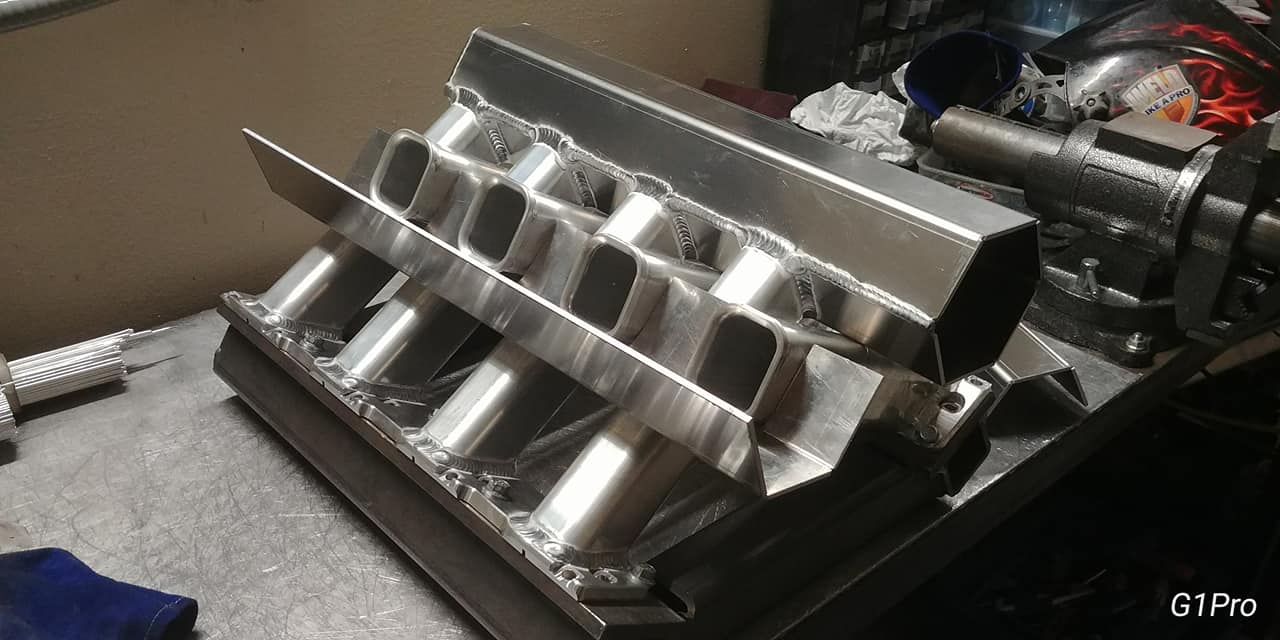

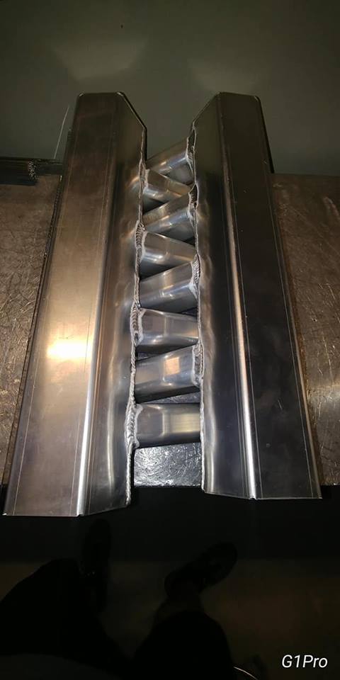

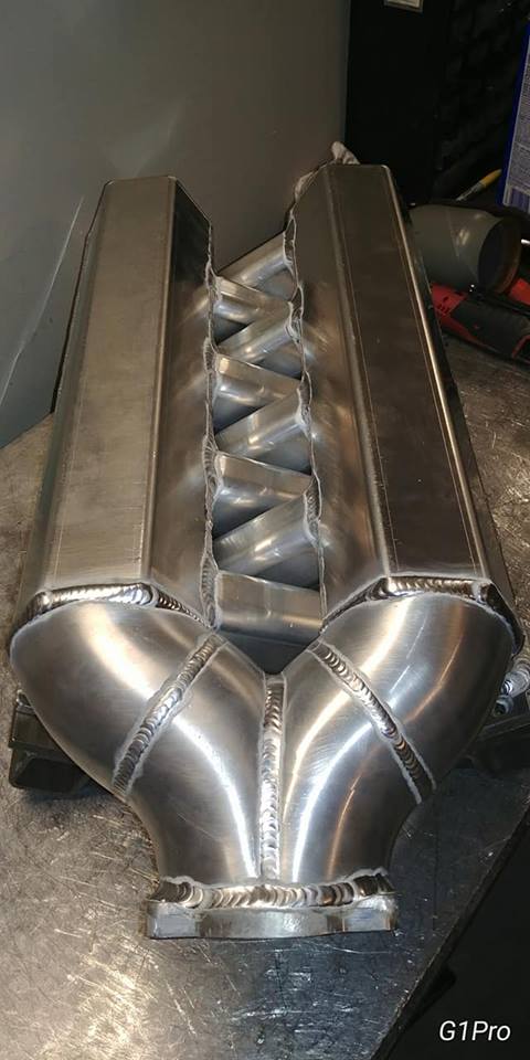

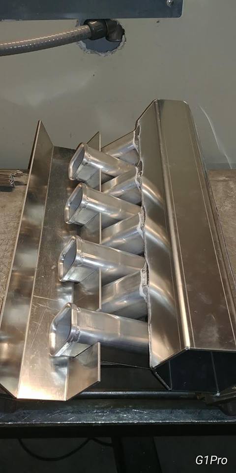

just felt like building something pretty cool and exclusive to the Camaro Community
will clear oem ss hood
can be single or dual tb (single utilizes a y pipe snout for either 90mm or 102mm)

Looks sweet. Do you see any performance benefit here or is it just for looks?
So cool stuff
This intake will see peak ve 2 times in a useable rpm range
Tuned
4th wave peak will be 4600rpm
3th wave peak ve will be 6200 rpm
What this should mean is one very long flat trq curve that should be good from 4500-7500 rpm

Originally Posted by Goertz View Post
So cool stuff
Tuned
Now just need a custom exhaust with a peak in the trough and mmmm
Also a balance tube (Like the GTR has) might be beneficial

If going single tb no need for balance tube.
Dual tb there will be balance tubes though
Shouldn't really be a dip between the rpms cause as trq starts to traper from the 3rd wave the 4th will be starting to come in.

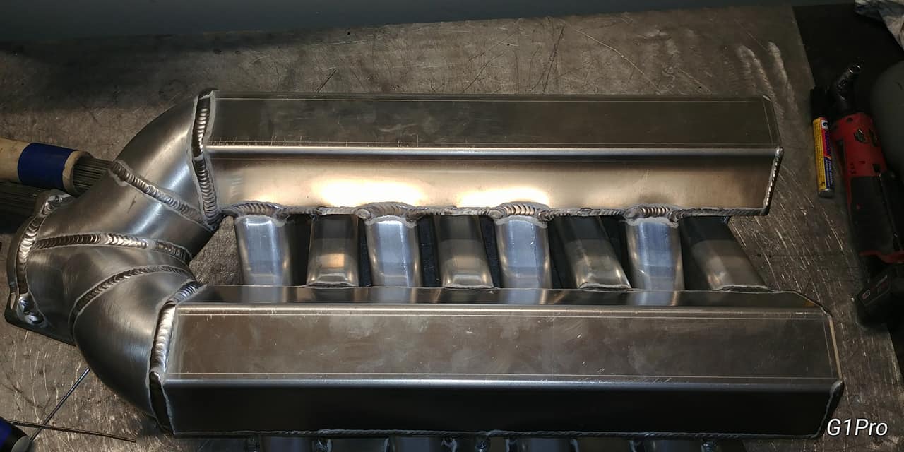

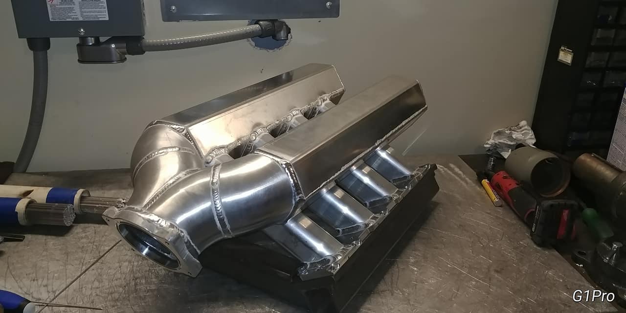

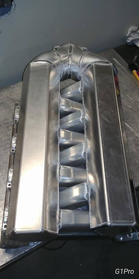

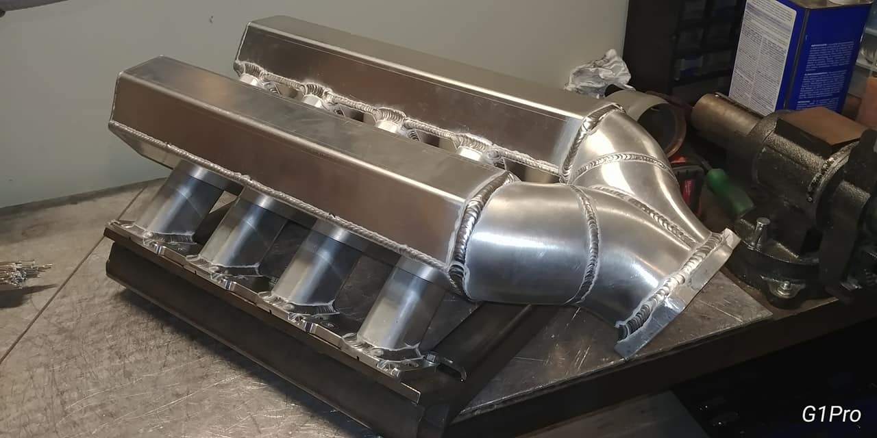

need to cut some new inj bungs at a different angle than my usual.
I'll finish this up a little later but here it is about 95% done
Just needs map, air fittings and inj bungs

Originally Posted by 6ChevDev View Post
Weight? Are these heavy?
my normal intakes are lighter than the oem plastic
i haven't weight this one yet
