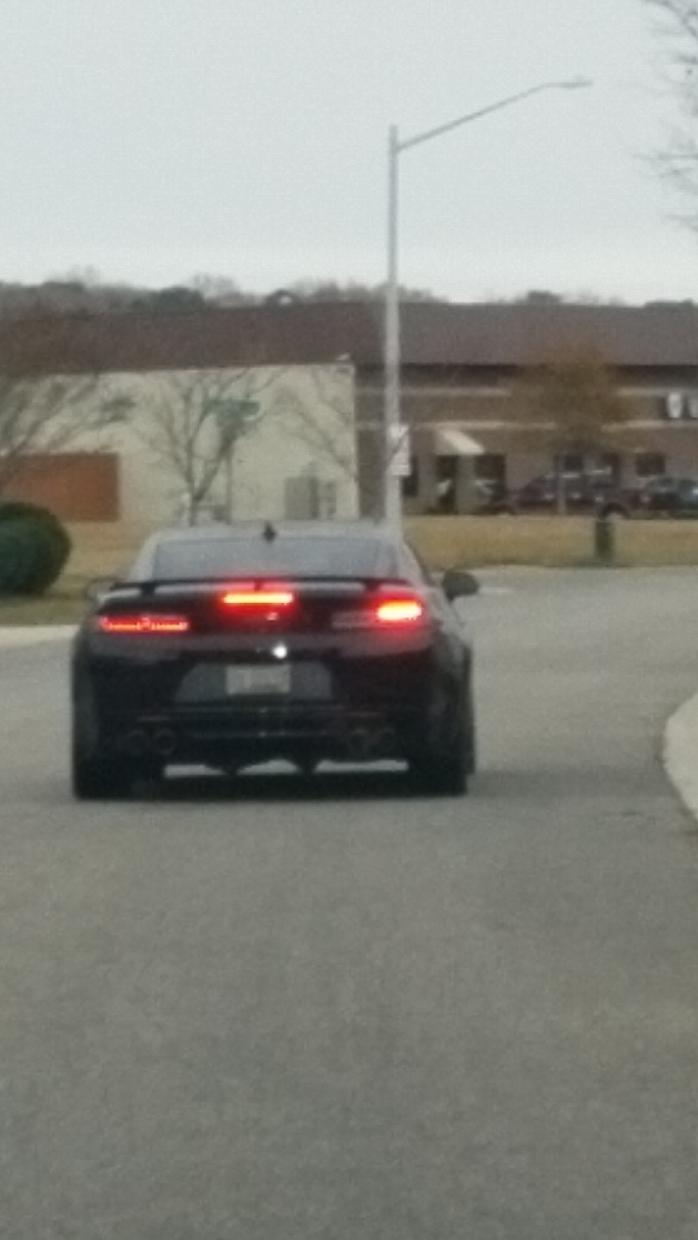

Ight so my car is freaking out. My taillights are not matching and my headlights aren’t either. On the right side my drl is out and on the left side the fog light thing is out. Soooo anyone know what it could be? The dealer has no clue what’s going on. The picture is with me in the brakes
I have longtube headers with no cars but that shouldn’t be an issue

It's a bad ground.
Tech needs to use schematic in shop manual and check appropriate grounding wires and terminations.
Check for paint blocking good ground.

Wasn’t there some wire harness that aftermarket headers could rub on?
