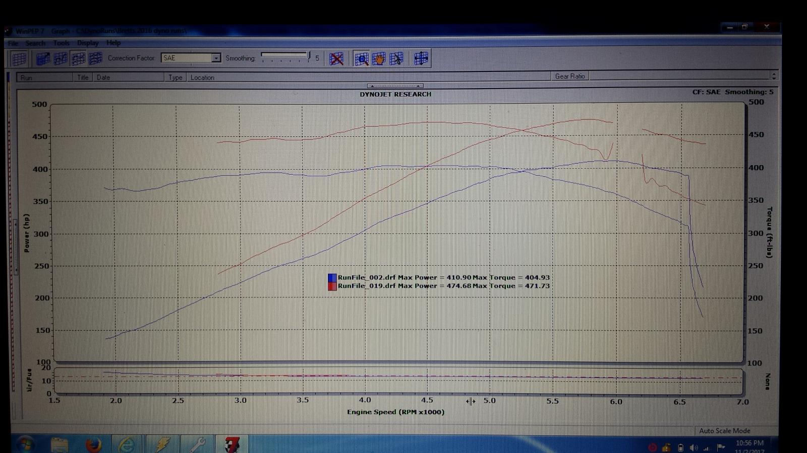

PRAY Performance bolt ons and Remote tune gains.
Just finished up a remote dyno tune with Gleider Lopez and his 17' 1LE. Big shout out to Gleider and his dyno guy for being such troopers. They would make a pull, send me the log and snap and pic of the fuel curve for me. I would make the adjustment and they would upload them and make and pull. It really worked out well.
Mods are:
PRAY Performance ported stock IM/TB
Roto-fab CAI w/ dry filter
Kooks 1 7/8" catted headers
EFI Tuning Flex Fuel kit 75% E
PRAY Performance Tuning
Next step is PRAY Performance ported heads and 500+rw.

Great gains!!

Not just at the top.. all the way through, that is area under the curve.

Yes!!!!! Im so happy with the result! This car moves!
Thank you Brett for dealing with me and my excessive questioning... before purchase, during installation and after (tuning part). Im definitely looking forward to those heads.
