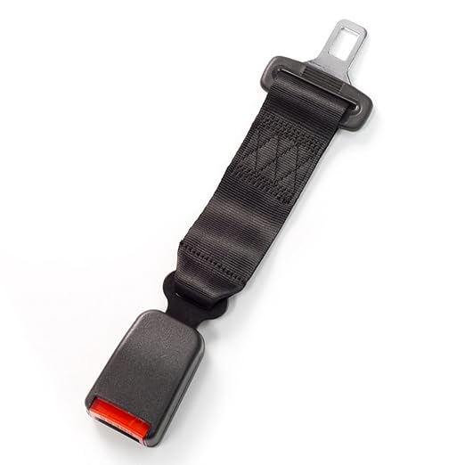

Go to your local Chevy dealer and have parts order a seat belt extender for a 2018 Camaro. They are no charge from GM.
Cut the webbing from the part that inserts into the stock buckle.
Insert it when you are using your Schroth Rallye 4 ASM harness.
Keeps the seat belt warning system from activating.
Thanks, I have two coming from my dealer.
