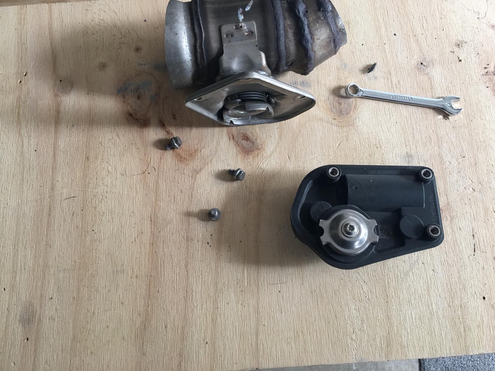

AFM fix for V8
First and for most, GM should offer the customer a choice from the factory or something else then hurting performance with valves in the exhaust system.
Once you start modding and adding performance parts you notice the shift from 8 to 4 cylinders a lot more. Then shifting in manual in a A8 just does not keep you happy anymore. I did my headers and exhaust, and got rid of NPP, values for both NPP and AFM. Did the cam and heads, DOD delete, lifter change for AFM and guides. Plugged the AFM holes as per instructions. Did it all.
Then with tuner we could not get rid of check engine light with exhaust codes because of the AFM delete. I talked to a few people on the forum regarding this issue. They assured me that I needed the plug in cables that are being sold here on the forum. I agreed, but kept thinking about the original AFM values.
So I looked at them and took off the 3 screws, the plastic part and electronics is all you need and best of all it's free!!!!! You don't need to spent $140 - $180 for AFM delete cables. So I went under car and hooked them back up, zip tied them up. Went for a cruise and pulled over. Cleared my codes with my reader, drove around for an hour and turned off car multiple times. No check engine light.

Do these AFM valves operate like the NPP valves...open by default, then closed when told to? In other words, are the AFM valves open in V8 mode and closed in V4 mode?
If yes, then couldn't you do this mod leaving the AFM valves in place and just disassemble the black housing with the plug (as shown above) and zip tie it like shown above? In essence acting just like the NPP fuse pull.

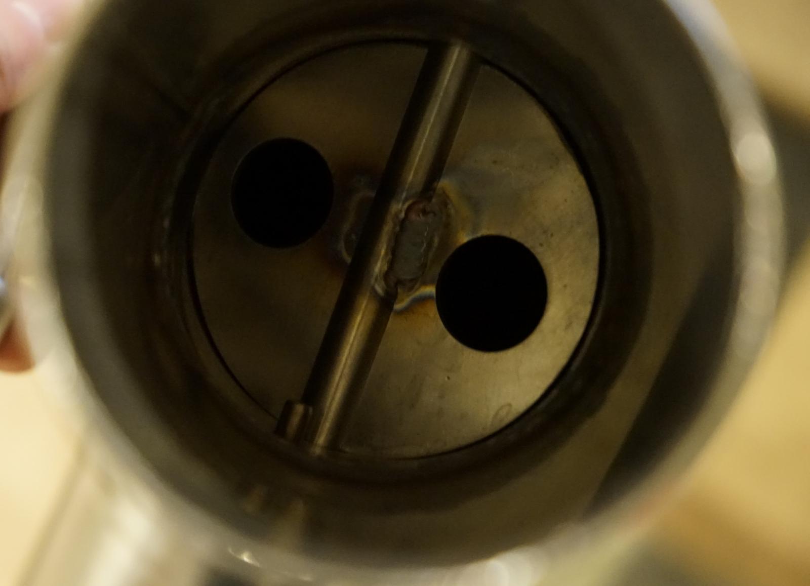

Want free flowing exhaust, those values and gates block a lot of flow. Even when it's open in track mode it hurts the flow. By increase back pressure on engine in the long run can't be to good on an engine, if constantly changing back and forth.
Maybe someone could help me out. I got a custom catback exhaust. The installer removed the OEM exhaust from the cats back and ziptied the AFM wire and the black plastic part with the motorized wheel to the bottom of the car. All my research suggests that i shouldnt be throwing a CEL but its still throwing an AFM CEL. The little motorized wheel still spins when it needs to from testing. Is there another reason im throwing a CEL? Anything i can do to get rid of it? Dont want to tune cause its new and i dont want to void the warranty. Im lost so anything will help.
Snyper25 is offline   Reply With Quote
Make sure the "wheel" that the electric motor turns is not restricted in any way. Some guys have tied the black box up and the wheel movement is restricted or limited and that will cause a CEL
