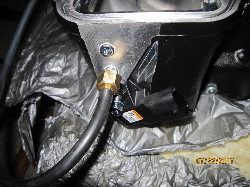

Where is everybody splicing into to read boost on analog gauge?

Who SC you have? I have a Whipple, I remove a plug in the rear of the case.

ESC vortech kit.

I tapped the bypass valve vacuum line on my ProCharger setup. Works well....but the gauge might be reading a bit high based on what the kit is supposed to make...

Why do this work when our car reads boost from the obdii port

will i need a different map sensor though?

Sometimes, a gauge in front of your face is better then just logging it. That’s why I have it. My gauge has a warning light and I can set the pressure at which it lights. It’s helpful when I’m racing to know if it’s higher then it should be.

I’ve got the Autometer digital. Nothing overly fancy. The light isn’t really bright enough to grab my attention, but it has a high boost memory, so I clear it before a pass and check to see where it peaked during the run. I can then verify that in my log from HPTuners.

Which thread size is it?

Your 2SS will not read boost through the OBD port with the factory sensor.

Sorry, I can't remember. I "think" it was NPT cause I found the fitting in my stock.

Correct, whipple uses a GM CST 3bar map in their kit.
