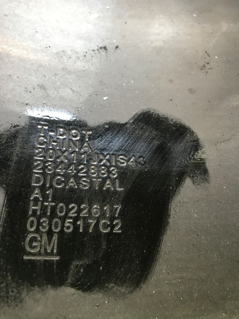

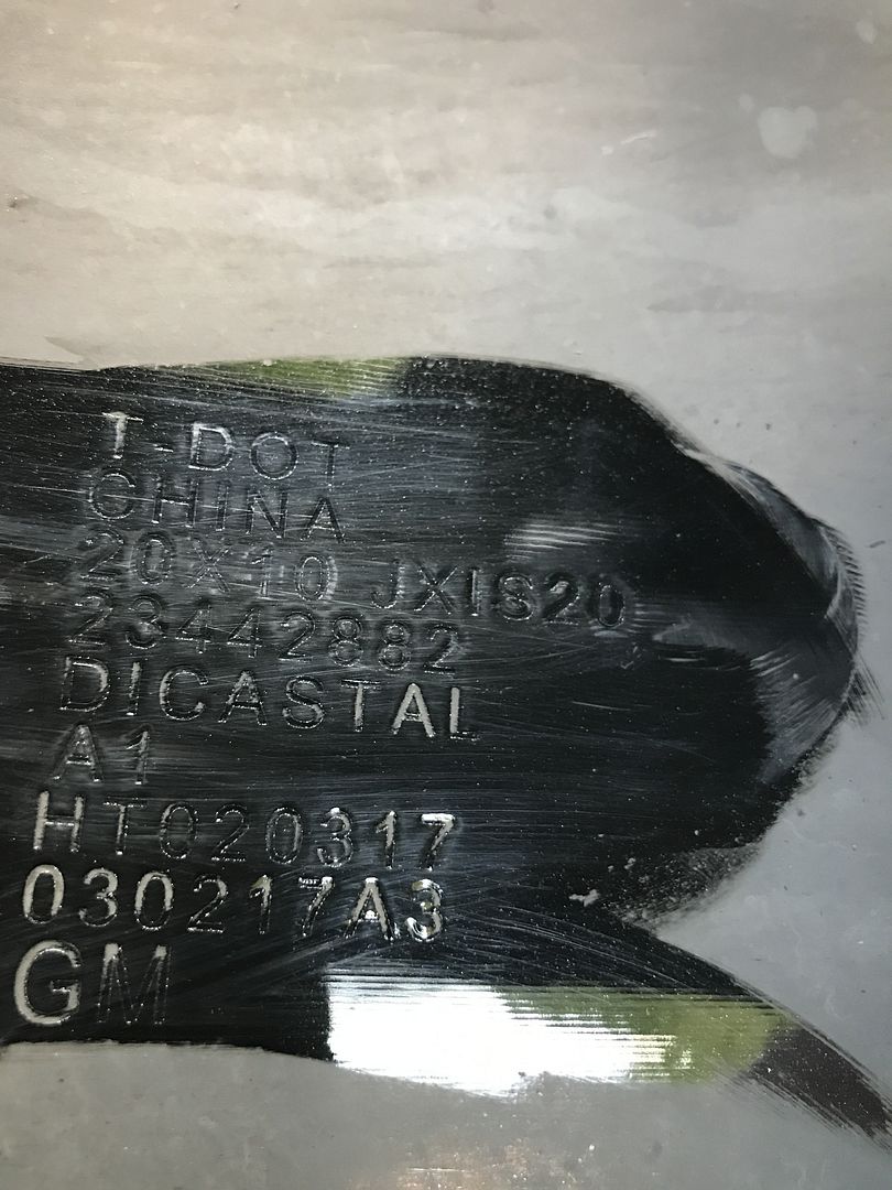

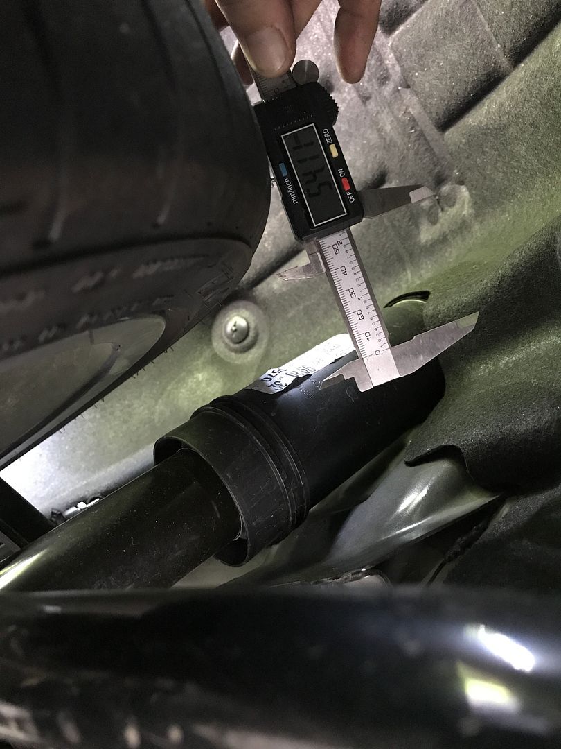

Well i looked a bit closer at the zl1 with the wheels off. The DSSC 1le struts up front are slightly different right above where the spindle meets shown in the photos. I would assume the shock bodies are the same size or very close, and according to what i see the to get the front wheels on the zl1 you would have to cut the mounting tabs some with and angle grinder. Oddly enought the standard ss is cut more like the red mark i have made.
Cant read my photo but there is 8mm clearance on those mounting tabs and the rim rides right where its cut, so if you was going to 19s that would have to be cut down 12mm roughtly. Its seems there is only around 8-10mm between the tire and the actual shock body, i would say only running 305 on this same rim may be very close to rubbing.
As for the Rear the shock has roughly 54mm, angle looks off in photo but its around 54mm, before you would hit it, tons of room, tightly area is at full droop and the tire is about 8mm from the fender liner, i noticed behind the liner there a wire loom and then 12mm back chassis. The 1le has hardly any droop, im guessing that is how they are getting by with it. Im no sure you would ever be at full droop unless either ramping the car or jacking it up.
Problem area in rear at full droop.
The offset codes on the wheels are the same as gm.
Front 20x10 jxis20
Rear 20x11 jxis43
For giggles put a rear wheel on the front and it would take a good 30 mm spacer to make it work, here is the photo on if 30mm out it would stick out.
[URL=http://s119.photobucket.com/user/lmcgrew79/media/Autos/2017%20ZL1/1D67AD1E-C2B8-4D16-B759-1121DFF84B15_zpskbaoqixk.jpg.html][/UR

Whether they fit or not will entirely depend on the offsets of the wheels, which is why I was trying to get that info now that cars are arriving with owners. IF the front is as rumour has it (19x11 +11), which is the same as the gen 5 Z28 wheel, they will fit, albeit they will be slightly close to the strut and if you run aggressive camber you will likely need a 3mm spacer. This is the same setup I've seen on Gen 6 cars with MRC. There was NO clearance issues when running stock camber (z28 wheel in rumoured size as ZL1 1LE wheel). The rears are an unknown at the moment, but as we know there is much more strut clearance in the the rear. Your last picture showing how close the rear tire is to the fender liner is a nonissue, remember, the 1LE wheels are 19's so you will be going down a full inch in diameter (assuming that you run 30 series sidewall like the factory 1LE does).

Can you check the inside stamp for the front and rear offsets, please?
