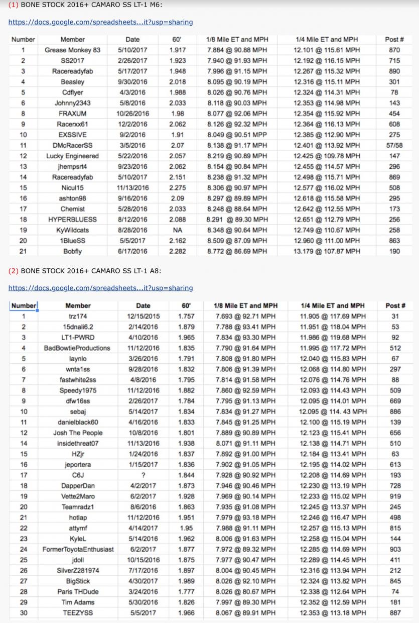

What if drivers have equal skill? Only the top 5 (of 20) from the M6 fastest list would make the A8 fastest list. The average A8 is 0.266 sec faster than the average M6. It's a lot easier for an average driver in a A8
Average 60' time are...
A8 - 1.868 sec
M6 - 2.042 sec
delta = 0.174 sec
Average 1/4 time are
A8 - 12.172 sec
M6 - 12.438 sec
delta = .266 sec
