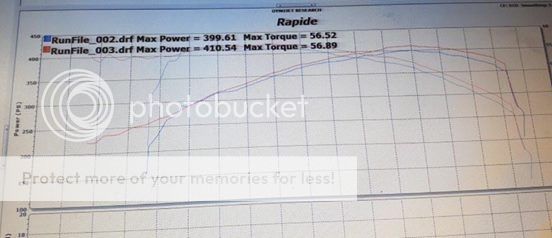

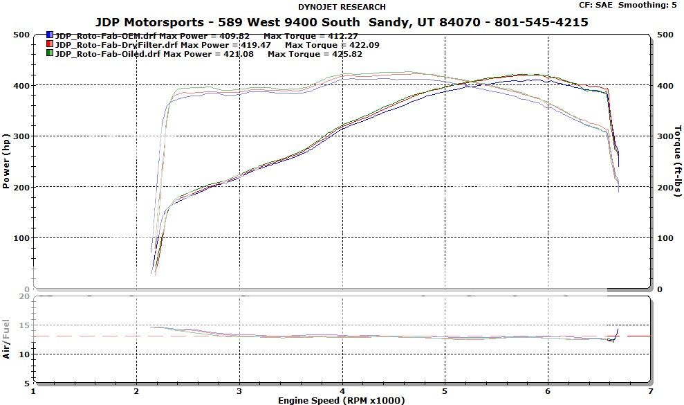

Originally Posted by Teem0s42 View Post
I'm considering getting a rotofab coldair intake (dry) but I don't want to tune so i can keep my warranty.... My question is if its even worth buying if I don't tune the car after install. Will there be any gains? Let me know your thoughts. Thanks
Here are some dyno results comparing the Roto-fab CAI to the stock intake system. We have seen gains from 6-14 HP on the the stock calibration. Our system is one of the very few mods which will improve your performance, appearance, and sound! To answer your question more directly, I think it is well worth it.
From JDP Motorsports, Bone Stock vs. Roto-fab, Stock tune
From CNC Motors, Bone stock vs. Roto-fab, Stock tune
From SCT Performance, Bone stock vs. Roto-fab, Stock tune, AFR included below.
From Abdulisraddd, supporting mods: secondary cat delete. stock tune.
