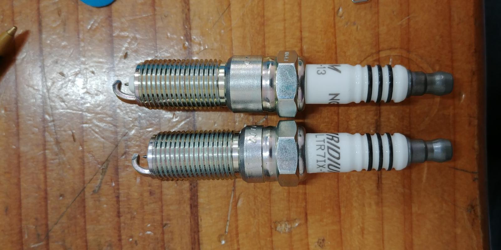

I bought the both and compared..
The size is little bit different..
