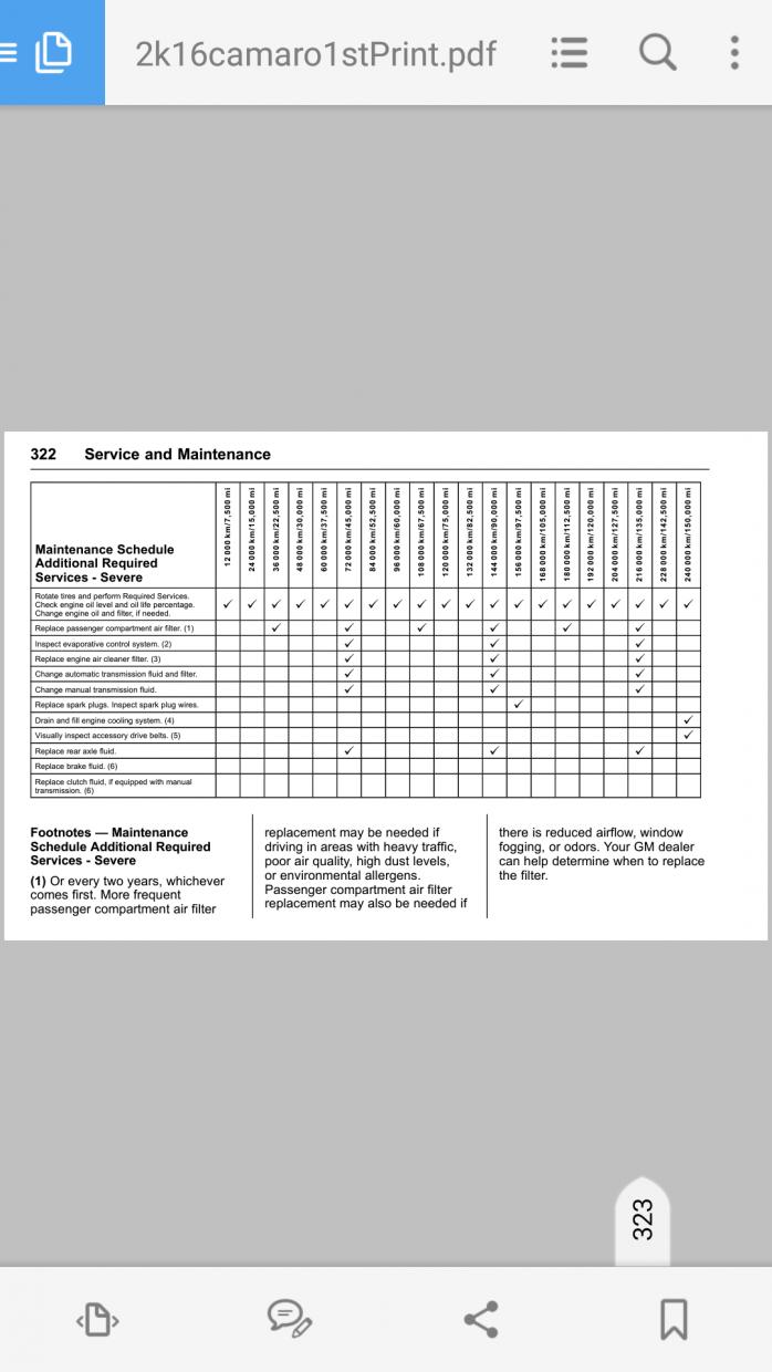

Diff fluid i did the first one at 1500. The second at 25,000 miles. Im at 32k now and ill prob do it again by 35k.
If you have the limited slip diff, 45k under normal operation.
For severe duty, or if you drive hard or spirited:
The manual says transfluid and filter & diff fluid every 45,000 miles or every 2 years....whatever comes first.

Did the diff fluid myself. That's just two allen screws and 1/2 a liter of fluid. 25 min or less really. Will have to use a fluid tranfer pump. 10$ at almost any auto parts store.
