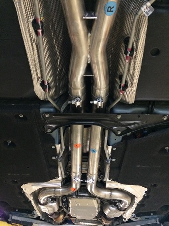

You basically replace this garbage with this nice stainless steel which is a uniform diameter throughout and it has a higher quality true x pipe vs the stock stamped x pipe. You do get better flow and it sounds better, it's not going to give you huge power gains, but that's not really the point of a cat back, you do them more for the better exhaust note and sound quality.

Correct, it's a true bolt on. Even the secondary cat delete is a bolt on, no welding either.
For the 60607 that you are looking at, you just make two cuts 3.25" behind the secondary cat on one side and 4.25" behind on the other and then the Borla mid pipes just slide over and clamp down.
Here's a pic and the install guide:

Oh, hey dude, you confused me on youtube because you had a mustang user name haha. You'll see the different options in the install guide I just posted but you essentially have 4 main options, with a cat delete or without, and either option is with or without the AFM valves (depending if you have the A8 or M6).
To answer your question, IMO I thought they were worth it, it sounds much better, it's opened up more and when I eventually do headers it will be loud but also have a good sound and exhaust note, so I can't wait!
Adding the mid pipe essentially makes the system a full cat back which give you more volume than an axle back, that deeper and louder sound.
