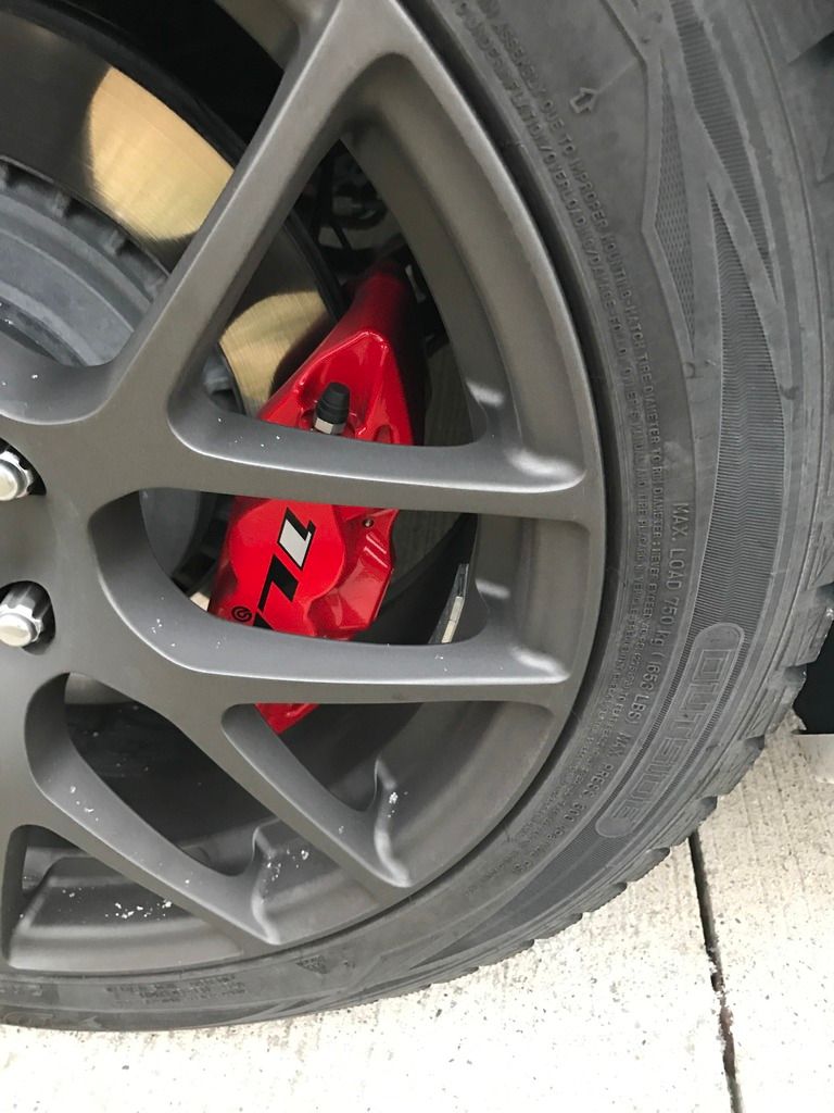

I am running square 245x45x19 Dunlop WinterMaxx tires on a 19x8.5 TSW Nurburgring wheel and have 3k miles on the setup
plenty of clearance on the brakes.......

I'm also running 245/45-19 Pirelli Sottozero 3 in a square setup with Verde Empire 19x8.5 et15. Fitment is nearly as flush as the stock SS 1LE wheels. The tire width effectively slices through the snow.
Weekend by Ryephile, on Flickr

I know were to get the tires but were did you get your rims and what should they cost??
