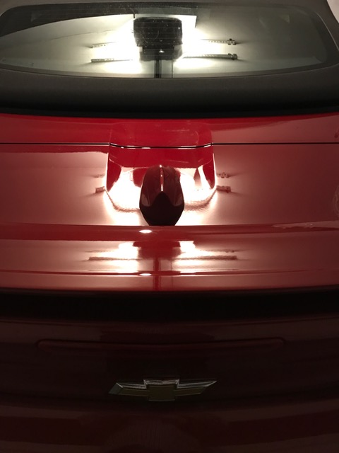

Most people wouldn't notice that my shark fin antenna is crooked, but I'm super anal and it's very noticeable to me...
Does anyone know if the shark fin is just bolted and has a rubber seal or is it double side taped and bolted? If I can pop the trunk liner, loosen a retaining bolt and reposition, that would be sweet.

OK, so as another member noted, the shark fins are bolted down with a seal at the base of the unit itself. The hardest part of straightening was removing the plastic retainers for the trunk trim. You'll need to replace the push pins as they do get damaged upon removal. I used a trim tool and needle nose pliers.. may be a better way, but that's how I got them out. After the trim is removed you'll now have access to the 10MM bolt near the manual trunk release. All you have to do is loosen the bolt, rotate the fin and hold tight while you snug up. It appears there's a threaded stop so you can't "reasonably" over tighten the fin. Be careful while you're tightening the bolt and watching the fin position, this is a great opportunity to scratch the deck with the socket wrench if not cognizant of it's position while the trunk is somewhat closed .
Crooked
