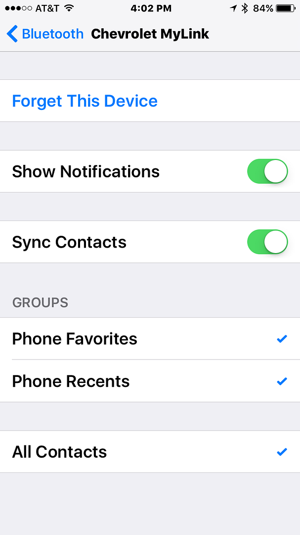

The Camaro does get texts, I get them all the time in my RS. You can only have them read to you. I have not tried to respond to one. You need to go into the settings on your phone, not the car, and look for the notification "on" in the my link Bluetooth screen.
This is exactly how my phone is set, still no texts

Try unpairing and repairing, as well as powercycling your phone

Mine worked as stated by others on here for the first week, then suddenly lost text notification function. I unpaired and re-paired, hasn't acted up since.

My iPhone 6S is set up like this as well. I have unpaired/re-paired as well as power cycled my phone. I still do not receive text messages on my MyLink via Bluetooth. Let me know if you manage to get yours working, Steve.
