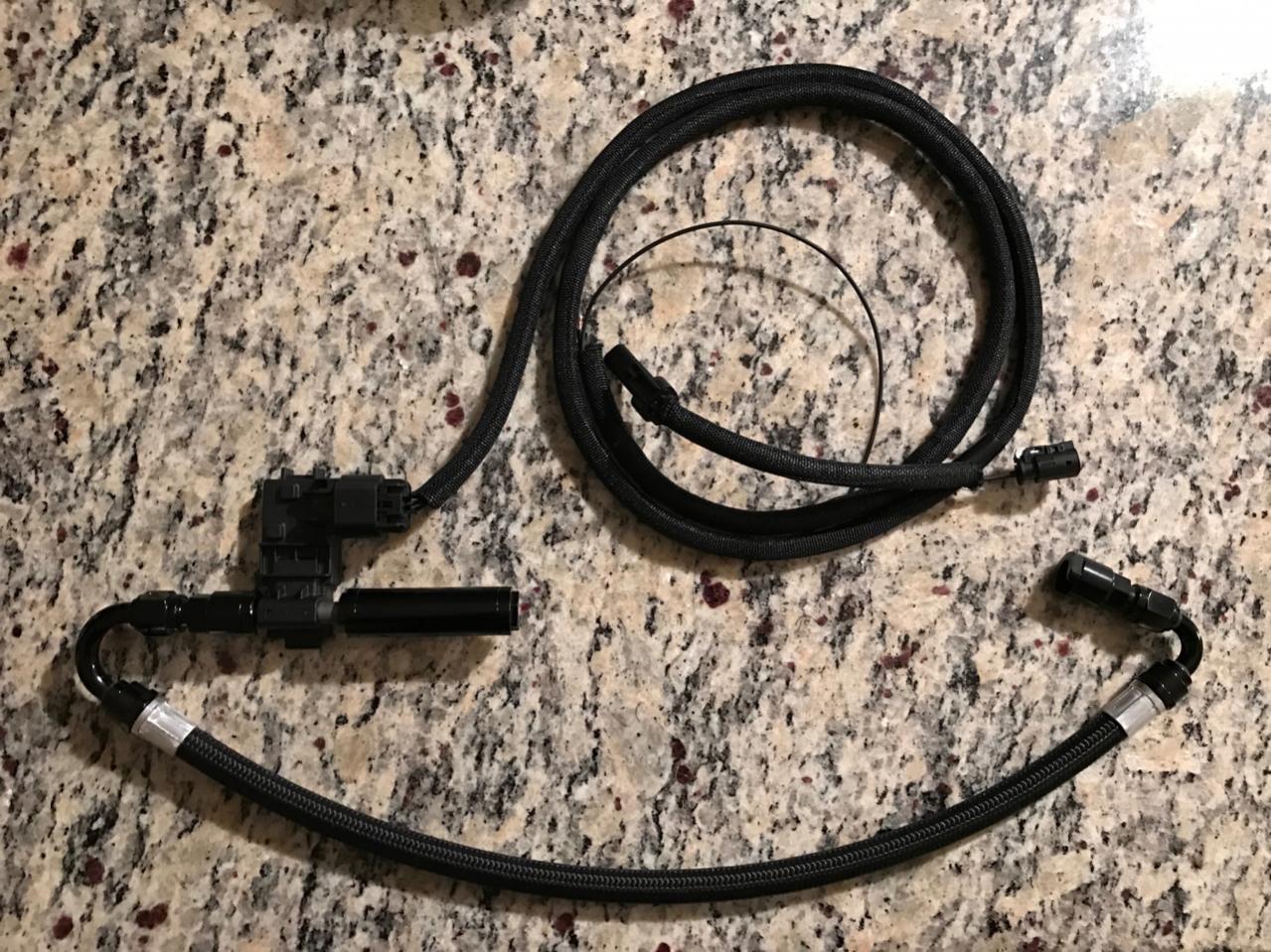

Here's a photo of what the final product looks like. I still need to add the ground terminal and the signal connector for the ECM but this will give you a good idea.

Thanks,
Tim
