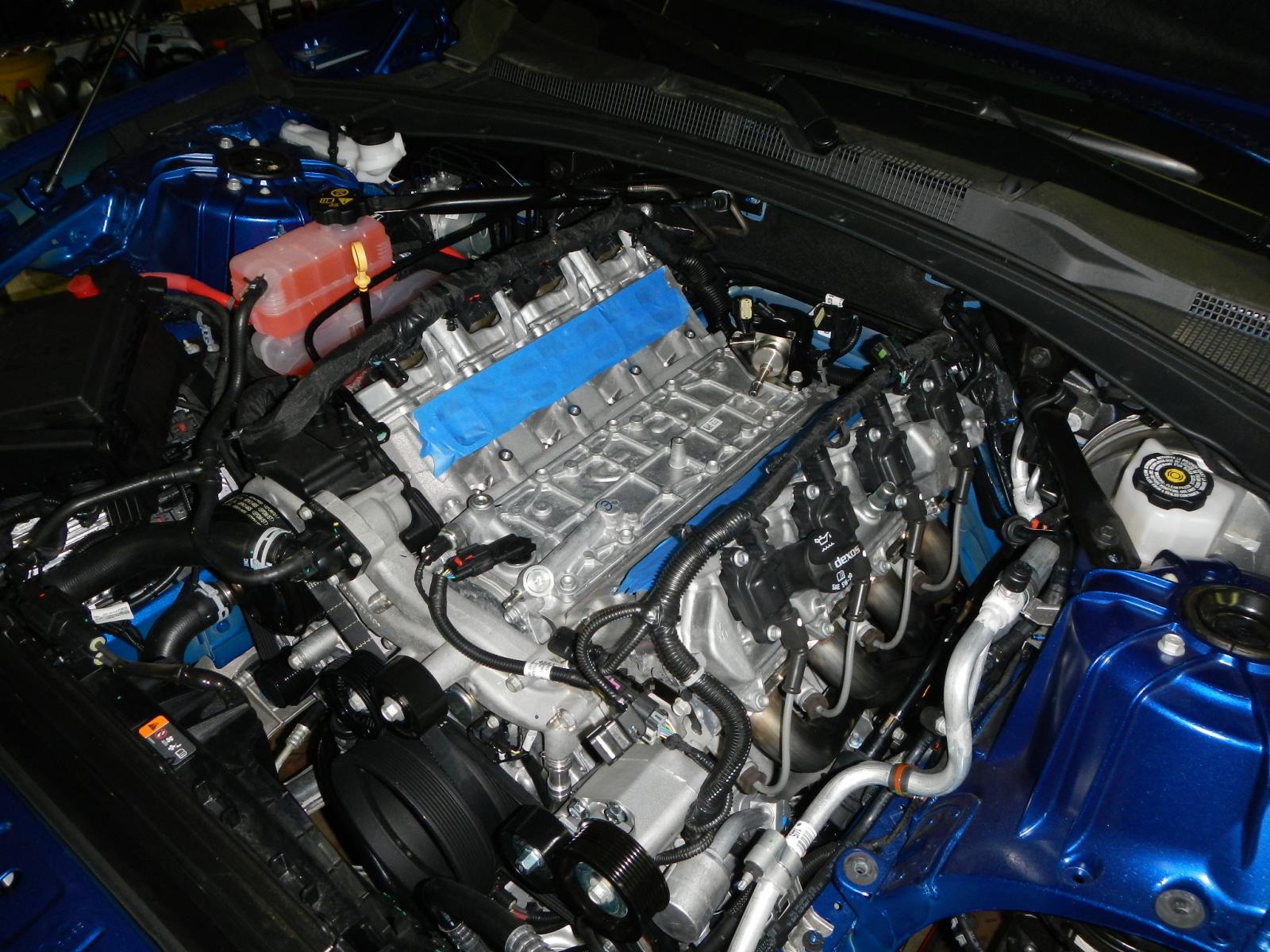

wow!!! ^^ same color and everything^^ do you have more install pics? pretty please with sugar on top? This topic, thanks everyone, makes me feel much better.
