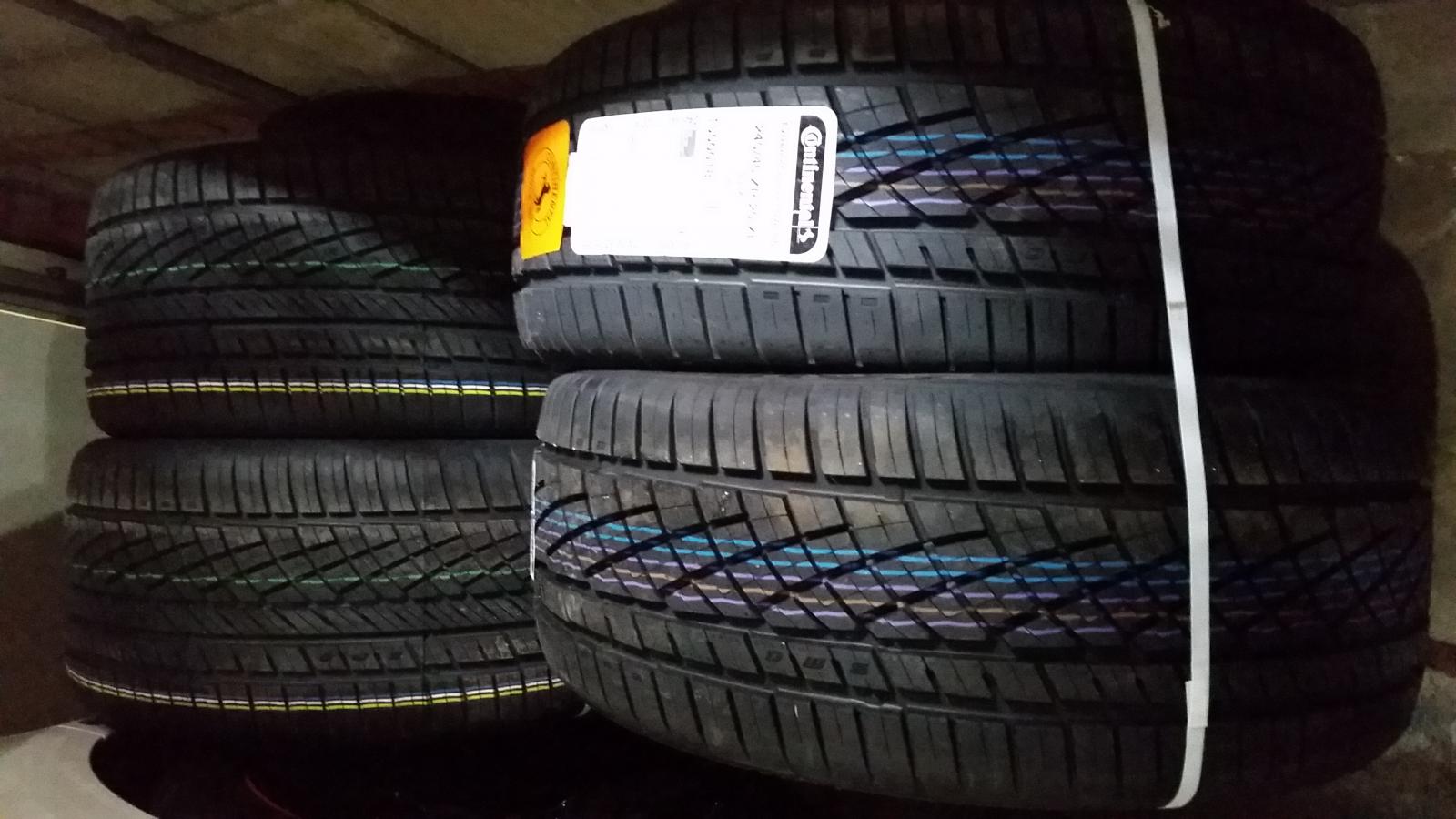

I am going with Continental DWS06. Had the previous version on my 5th gen and they were great. We don't get much snow here though.
Wolvie70 is offline   Reply With Quote
Old 09-09-2016, 08:28 PM   #12
keon718nyc
Location: New York City
Posts: 1,928
DWS06 are a great choice and plenty of write ups here in the forums about them. I have mine in the garage for this winter but trying to wear my stock tires more before i make the switch to them.
