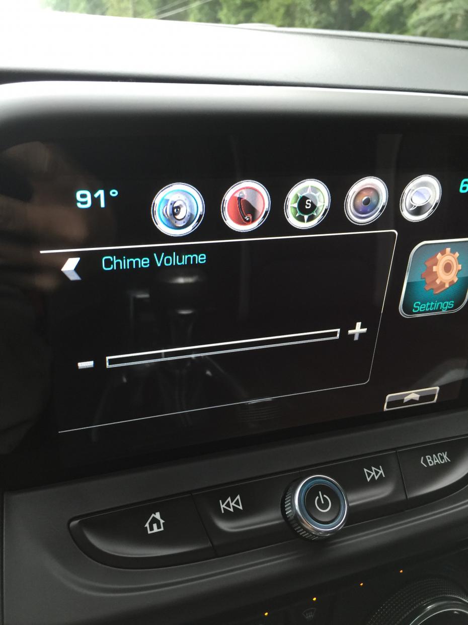

Try the chime volume in vehicle settings

Turn chime volume all the way down in settings. I've never had this problem, I shut the chime off day one.

Didn't even know there was a separate volume control for the chime, I'll check this out. Thanks!

Checked settings and the chime was already all the way down... I turned it up a bit then back down, we'll see if that fixes it.
This is how it was originally:

I think the chime in the settings is different from the traffic notification chime. I did set my chime in the settings to zero, but the darn notification chime for traffic still comes on loud and overlapping the announcement. I also checked in the navigation menu with no results. You can just turn off the notification prompts. It's annoying as hell.
