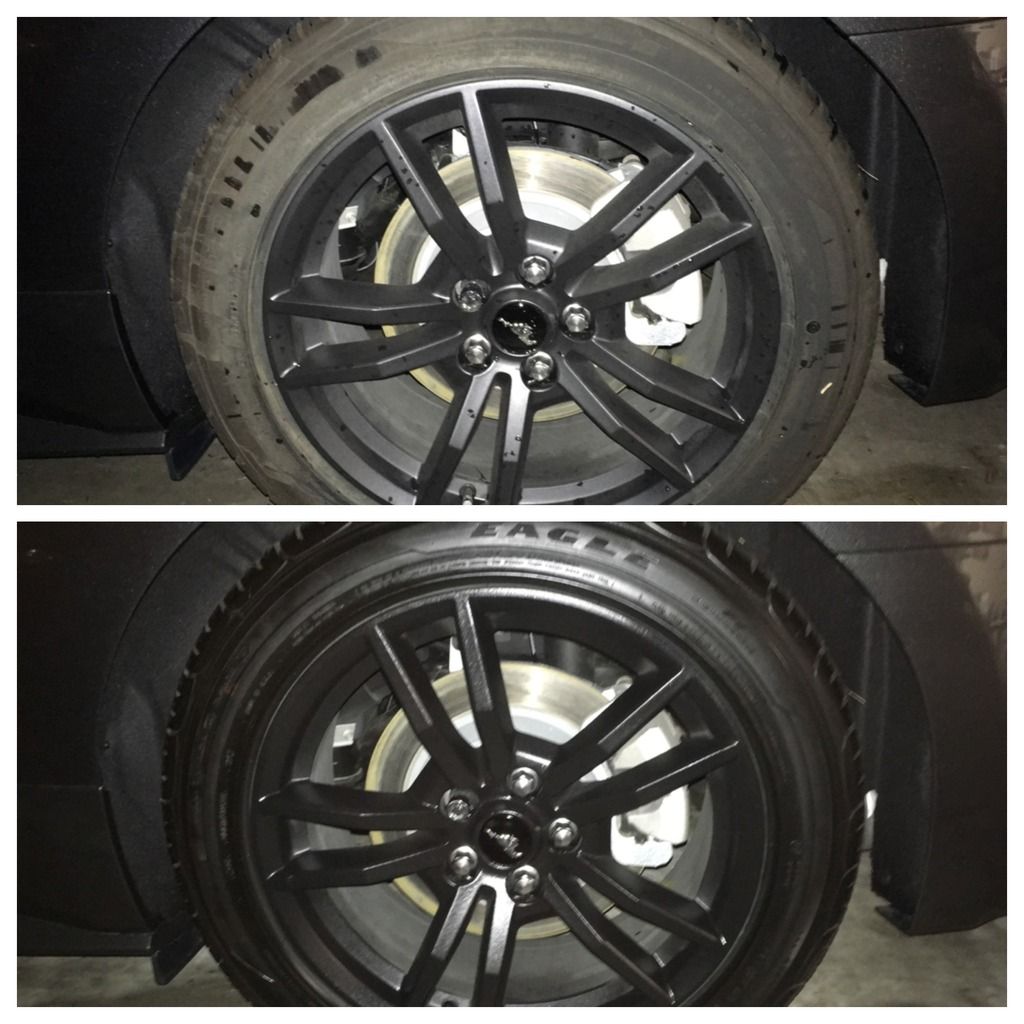

I used to have Plasti Dipped wheels on my Gen5. Adam's Super VRT is great for coating plasti dipped wheels. Helps keeping them looking new and from wearing out.
This is a before and after picture after using Adam's VRT on the wheels and tires on my brother's Mustang... (yeah i know, I tried but he will never convert)

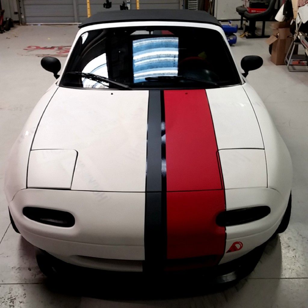

I was wondering if I can paint a thin red outline on these dipped wheels?
Make it look like those $1995 OEM wheels. Which type of color will adhere to the dip?

Just put a pinstripe on it. Buy the pinstripe vinyl at any auto parts store.
If you're hard up to paint, that'll be a lot of work masking. But enamel spray paint will stick on top of PD. Or you could paint the red in enamel then mask it off. Paint the PD then remove the masking over the red. You'll have to cut the edge with a razor, or it won't separate cleanly.
I did similar on my track car.
