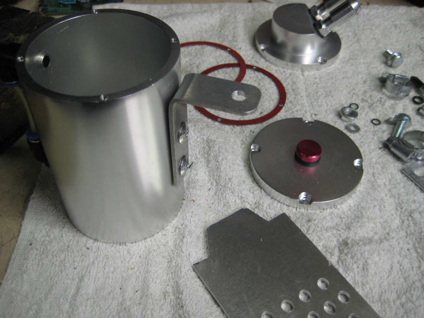

Not that hard to do...Here's a $38 Ebay one I modified for a GTi...
For what it's worth, the VW guys found there was no difference on Valve carbon build-up with or without over 50K (for each set-up). These guys have been doing some extensive testing on this car that has a known Carbon build-up issue. It happened with or without the can.
But if it makes you feel better...................................
More how-to pics here: http://public.fotki.com/ttschwing/gt...uff/catch-can/

$180... some people are selling like $300 dollar ones.
I have a never-been-used ebay one I got a while back when I thought the V6 could make use of one that i'll probably put up for sale along with a drop in K&N filter for the V6 that's barely been used. The cheapy ebay ones lack baffles but they are still effective.
Yeah...You need to put a baffle in them as well as a dispersing media like Stainless steel wool etc..
