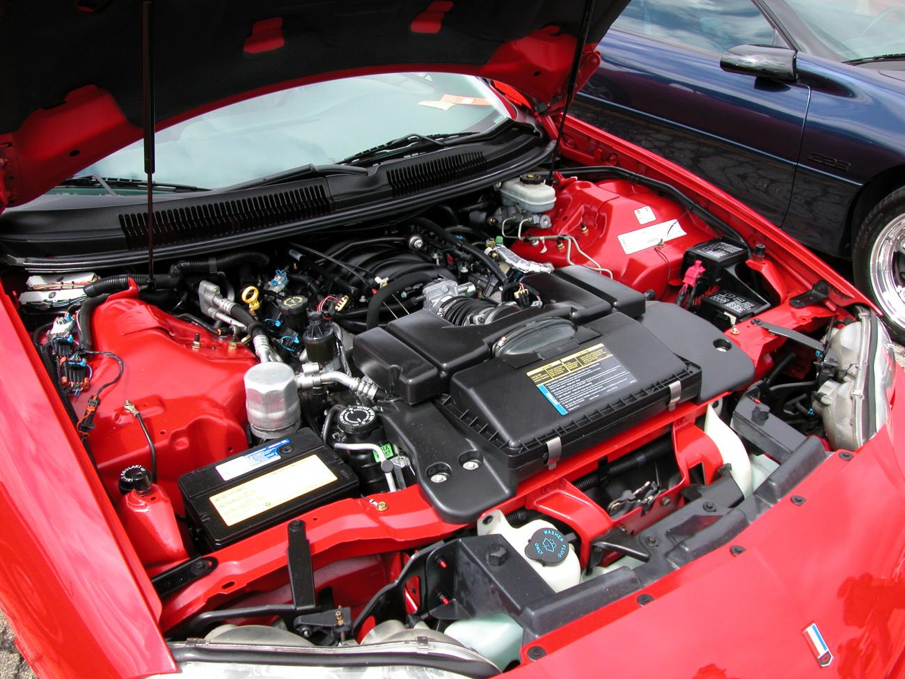

Starting with the TPI 305 and 350 engines in the mid 1980s, GM used a straight air intake tube because, frankly, there was enough room under the hood on the 3rd and 4th gen F-body platform to do so. If you look at the 5th and 6th gens, there is no way you can run a straight tube.
If you recall, the engine sat way back in that chassis. The back of the engine was under the dashboard:
fastball is offline   Reply With Quote
Attachment 759330
Actually the engine wasn't really back further, the huge windshield just covered part of the engine and the strut towers were further forward. The 4th gen platform was nearly the same as the 3rd gen.
