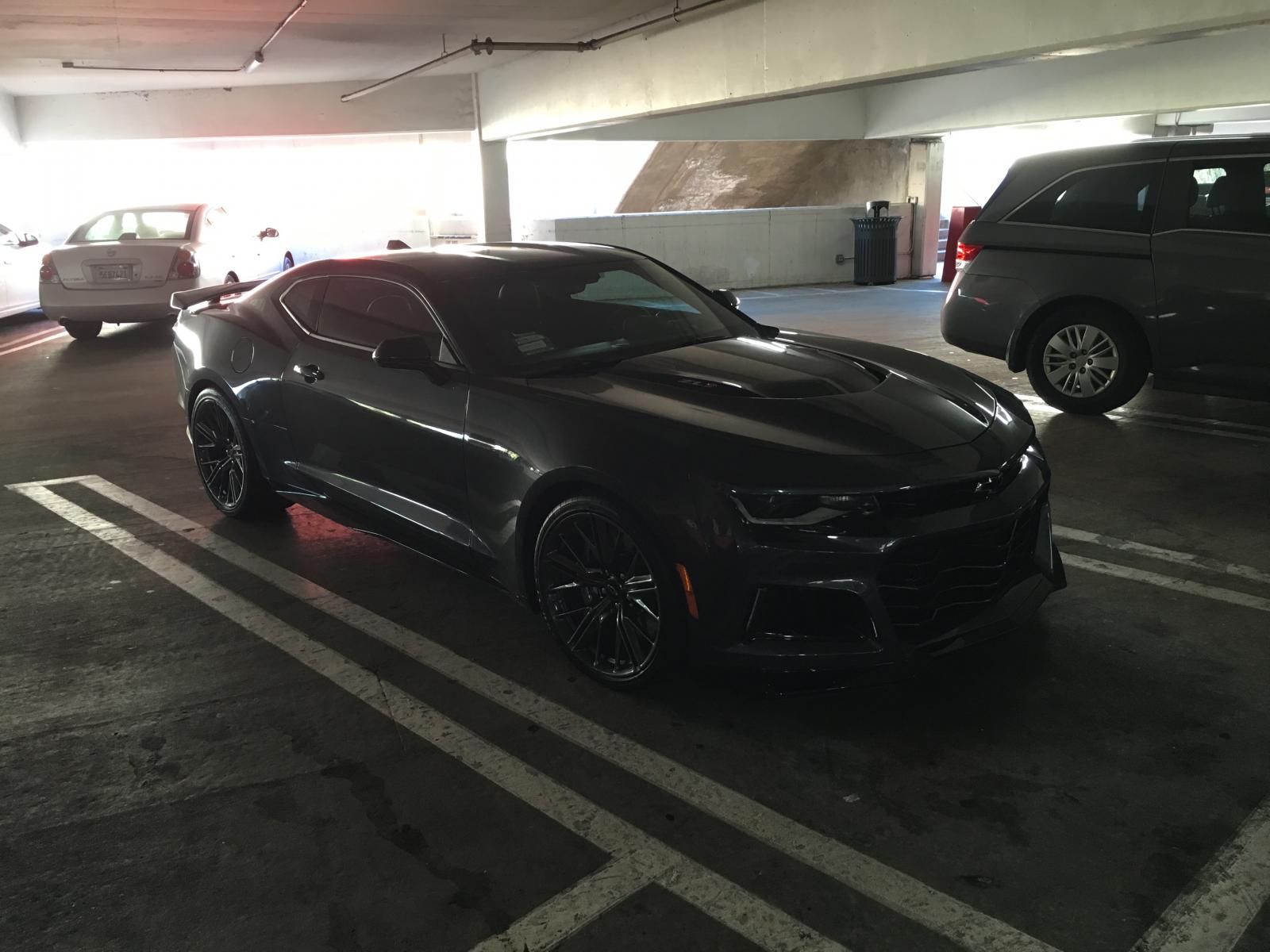

Funny thing. I sold the White 1SS 1LE to Carmax a week later and bought a Shadow Grey Metallic ZL1 A10.
