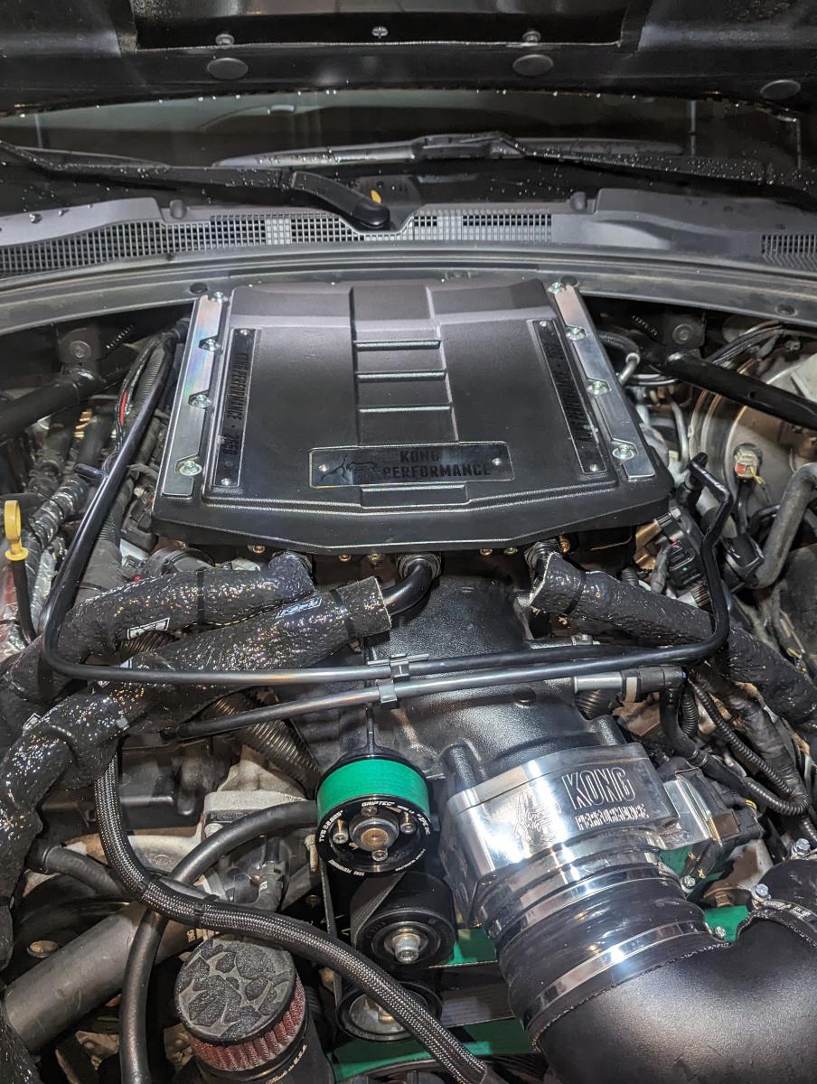

I bought a CWA-150 and it’s sitting in my garage. That’s definitely going in this winter. The Varimax isn’t cutting it IMO.
The car was in the shop this week for:
Pierburg CWA400 (heat wrapped),
DSX belt idler assembly,
2.625 upper pulley
DEI Fire Wrap on engine compartment hoses,
Shift light,
Repaired RR level sensor link, which wasn't planned.
I decided to postpone a redo of the tank's plumbing until I see how much good this project accomplished.

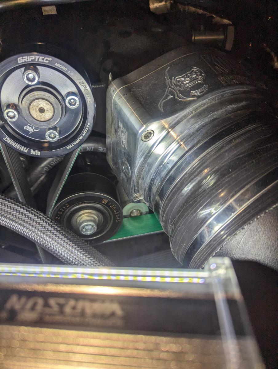

You can see the hole where the stock idler was mounted and DSX bracket provides a lot more belt wrap. I'm also going to wrap the engine water hose.

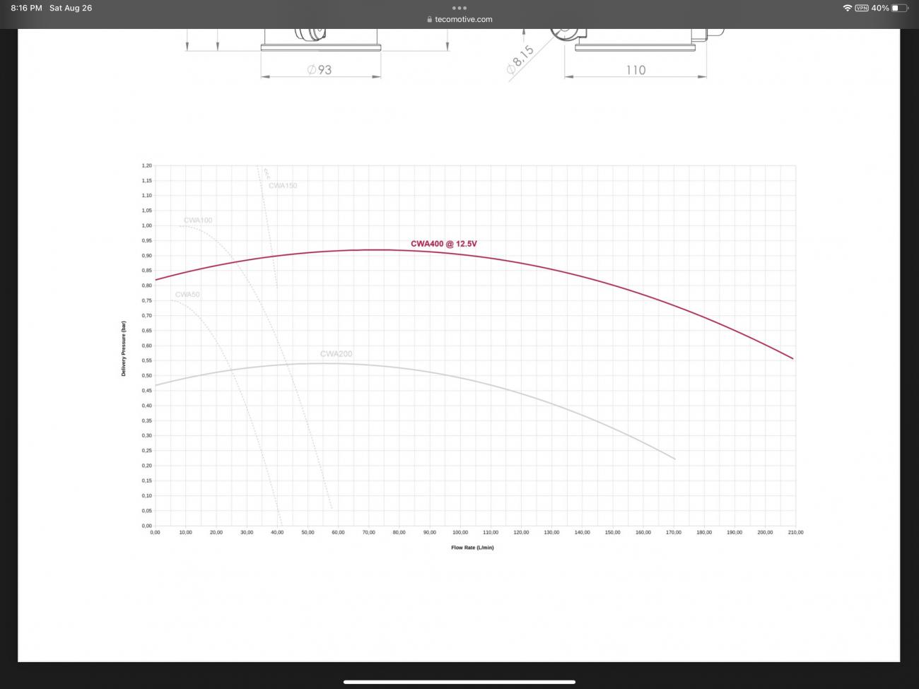

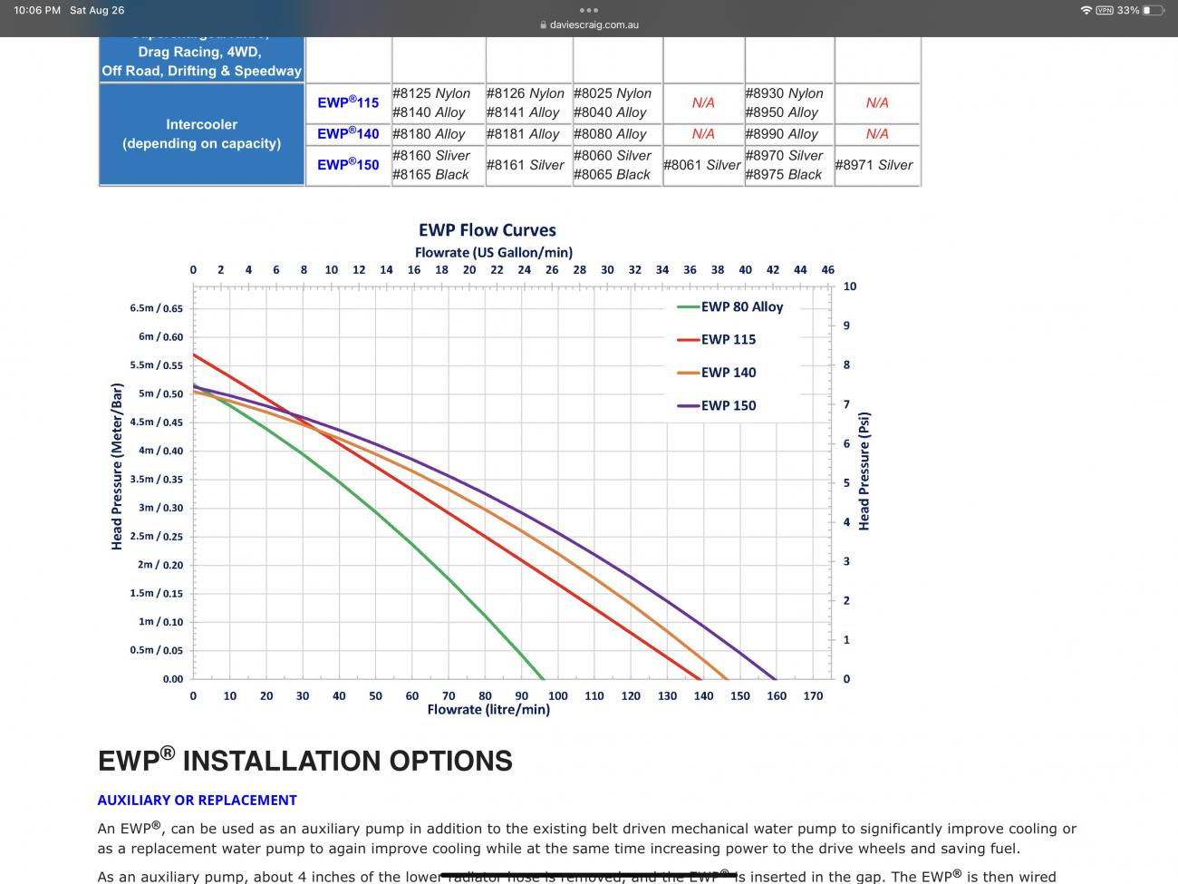

Looks like the new Pierburg has nearly triple the differential pressure of the Davies Craig pump so it should be able to really force the water through the tubing, even if it’s a bit undersized. Looks to be a pretty significant difference. Pump curves attached.

Yeah, I didn't know the figures were that large, but the difference was immediately obvious when I turned on the pump. Thanks for posting the diagram.
