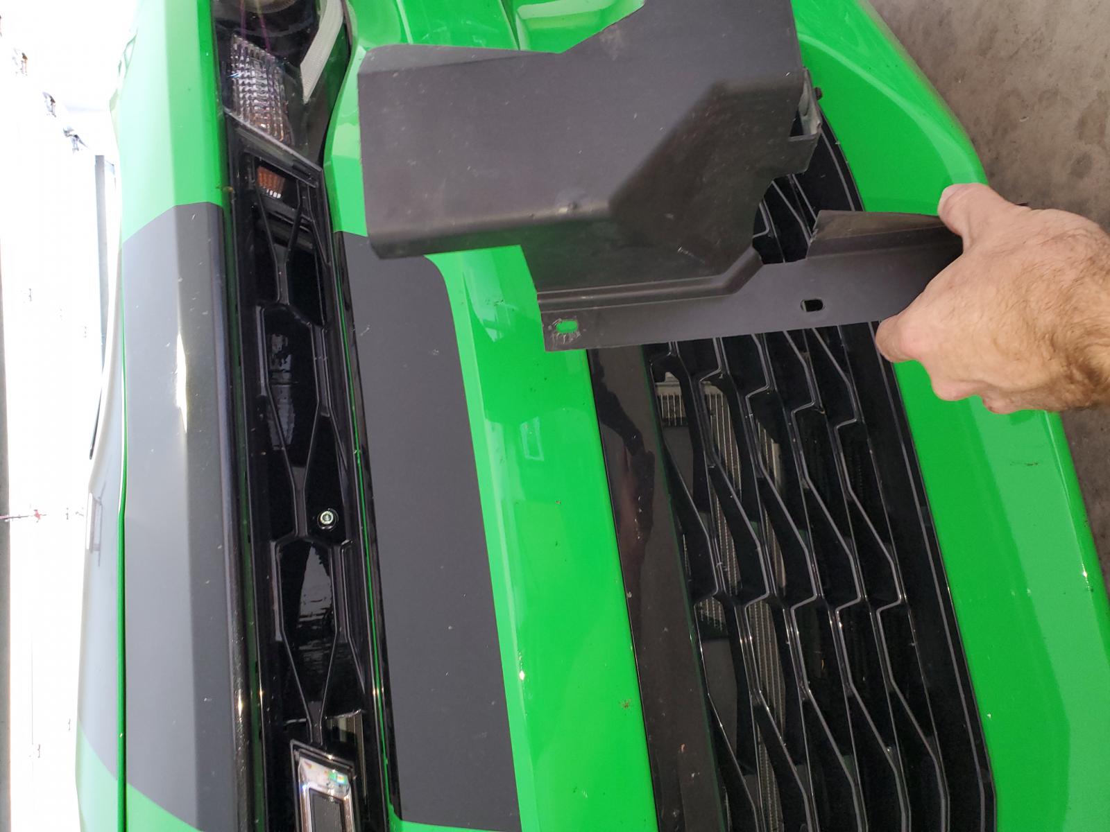

I went ahead and installed mine through the top as well. Benefits to be seen/had next season I think. I initially thought it was going to be a challenging game of "Tetris" but with one right move it slid into "proper" position for a final adjustment and bolting. I did lose the smaller of the two plastic bolt hole covers into the abyss trying to get that last final piece seated in place while working through the grill. Also note, the hood latch bolt on drivers side gets covered by the unit limiting the ease of that reinstall too. But all and all as stated doable...without a bumper removal

I installed mine today, it was a breeze! Fit and finish is very nice, I just dont know what to do with the two plugs and keep them in, so I shot the developer a question about what he does with them.

I was dreading it tbh, last time I took that radiator support cover off it was a pia, this time it was different. I found pulling out towards the windshield on the passenger side while the drivers side went under the front to be the easiest, if that makes sense. Then big mouth put skinny side in first to the left of the chevy logo then it will wiggle into place.

Same with me, I did a bunch of mods at once, so I'm unable to tell. The guy got back to me, basically I asked if I could put a dab of silicone on each plug, just enough to hold it there. If I need to get the plug out, to run a screw into the small hole into the plug and pull it out. He said it was a good idea, so anyone going ahead with this, that's the plan. Just dont use too much silicone as you may want to take them out at some point.
