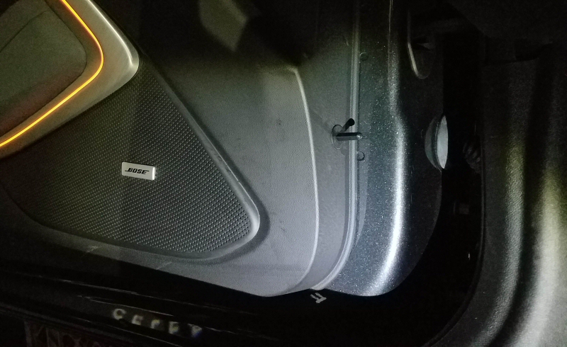

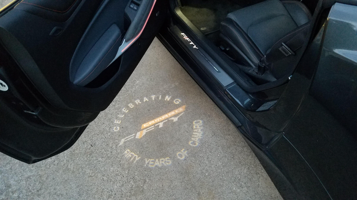

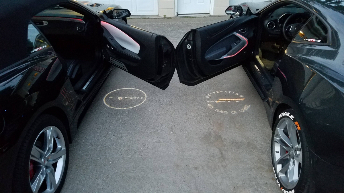

I finally finished this project. The install went easier than I thought it would, once I decided I would have to use an old fashion plunger switch to turn them off when the door is closed.

Awesome job! Did you make those yourself?

Yes, sort of...I replaced the gobos in a cheap set of puddle light projectors, with graphics I had printed out to color slides.

Very cool but surprised you had to make a switch. The Oracle puddle lights tap into one of the sources that only comes in when the dome light is on.
Wish stuff like this was stock. Rustangs have them.
Are you sure? The only wiring instructions I could find, involved connecting to circuits in the chassis. and I wanted to confine it to being completely in the door trim panel if possible. (As opposed to the 5th Gen where I had to leave a few feet of wire coiled up because the connections are inside the door behind the speaker.) There are battery positive and ground wires available at the main trim panel connectors. I used these ( https://smile.amazon.com/gp/product/...?ie=UTF8&psc=1 ), mounted in the forward face of the trim panel, about even with the speakers. It ended up being neat and tidy, and the trim panel comes away clean and self contained when/if it needs removing again. The switches are not really very noticeable under normal lighting and viewing angles.
Mine are only on when the door is open.
