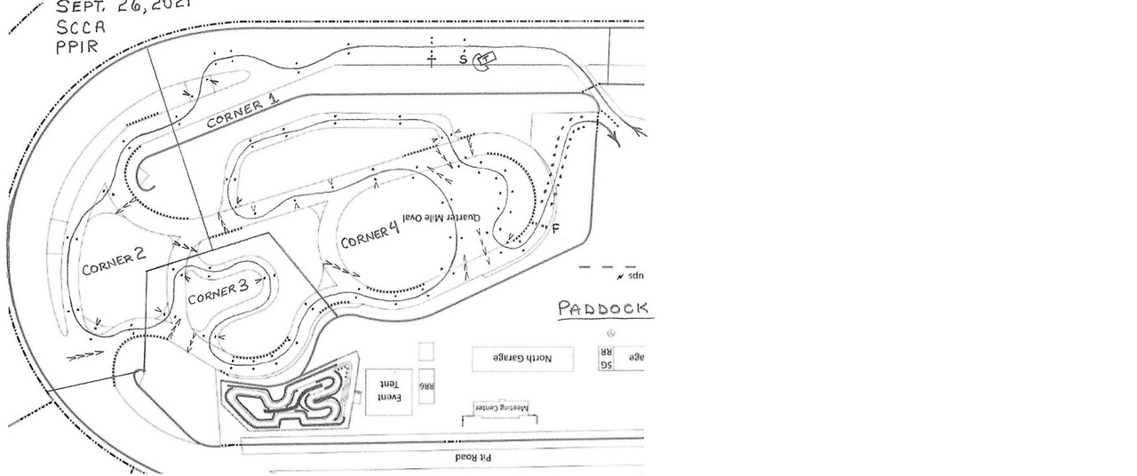

Nice finish @joelster!
Any tips for the course I'm running on Sunday?
I like PPIR courses much better than some of the short but very technical courses we often run at another venue. This may be ~80 sec!
