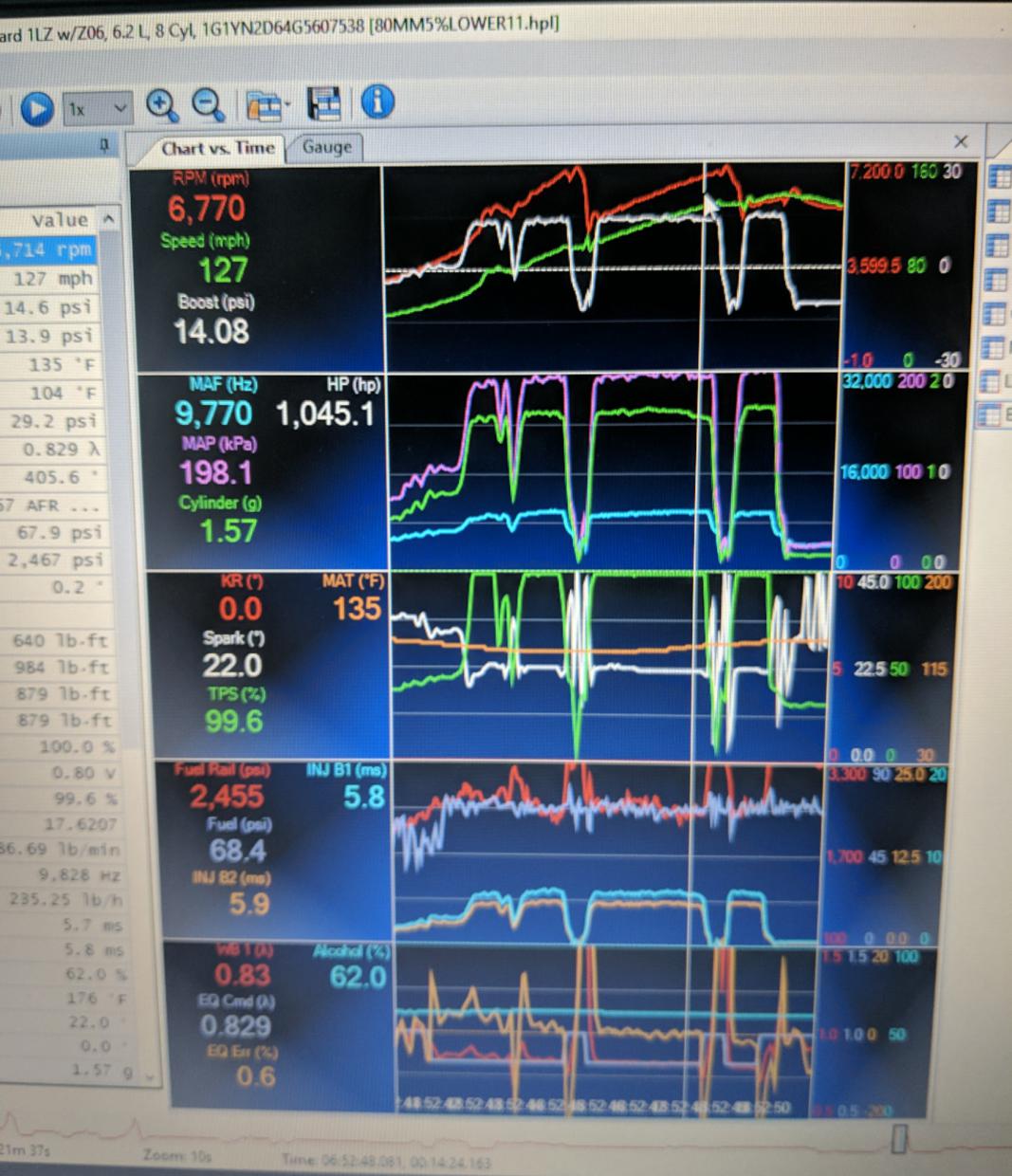

What gear did you make the pull? Imo the fueling shouldn't change that much in a higher gear. Imo you want to be an at least 5th gear on a A10. If you make a pull in a lower gear it will bounce around more.
For example here is my brother's C7Z M7. Second gear the EQ error is bouncing around due to load and tire spin. 3rd gear look at the EQ error is less then 1% through the gear.

unfortunately traction has been the issue...i nail it 40+mph and it starts skating and back out to recover then hit it again and it seems i can push it down the road. I will have to double check what the actual gear is.
On that pass, his Fueling looks a little low. Did you say he has a DSX low aux pump too?

I would down shift in manual mode, hold 5th gear, and make a pull just through that gear. That is how I tune fueling. I was making 3rd gear pulls from 40 in the C7Z M7 to dial in the MAF so there is no wheel spin. The log I posted above was an example of why you can't tune off of lower gears...it was a final pull not used to tune.

gotcha!! good idea...i will try it with paddle shifters...Last 2 times i put it in PTM Race mode, but i manually have the Suspension in Touring. Reason i put it in PTM is i have the Chevy Perf elsd update and was hoping it would help with wheel spin and keeping it even left to right.
