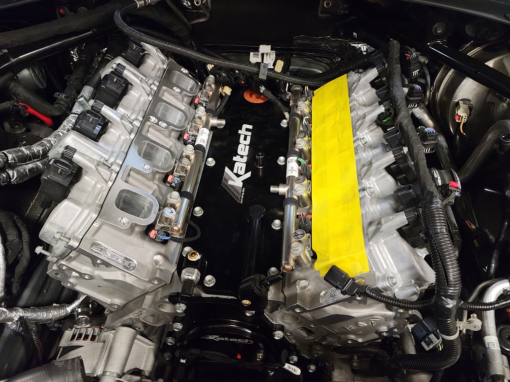

Progress. I like how they take their time and do it like it's their car...

Originally Posted by Motor Fast View Post
Wonder why they put the heads on in the car when they had the block out.
Time.
Our bottle neck is the cylinder head department.
So the engine gets pulled out, torn down, cleaned, along with the front cover and oil pan resealed all on the stand. If the cylinder heads aren't ready at that point the engine will go back into the car and the heads will get bolted on after the fact.
