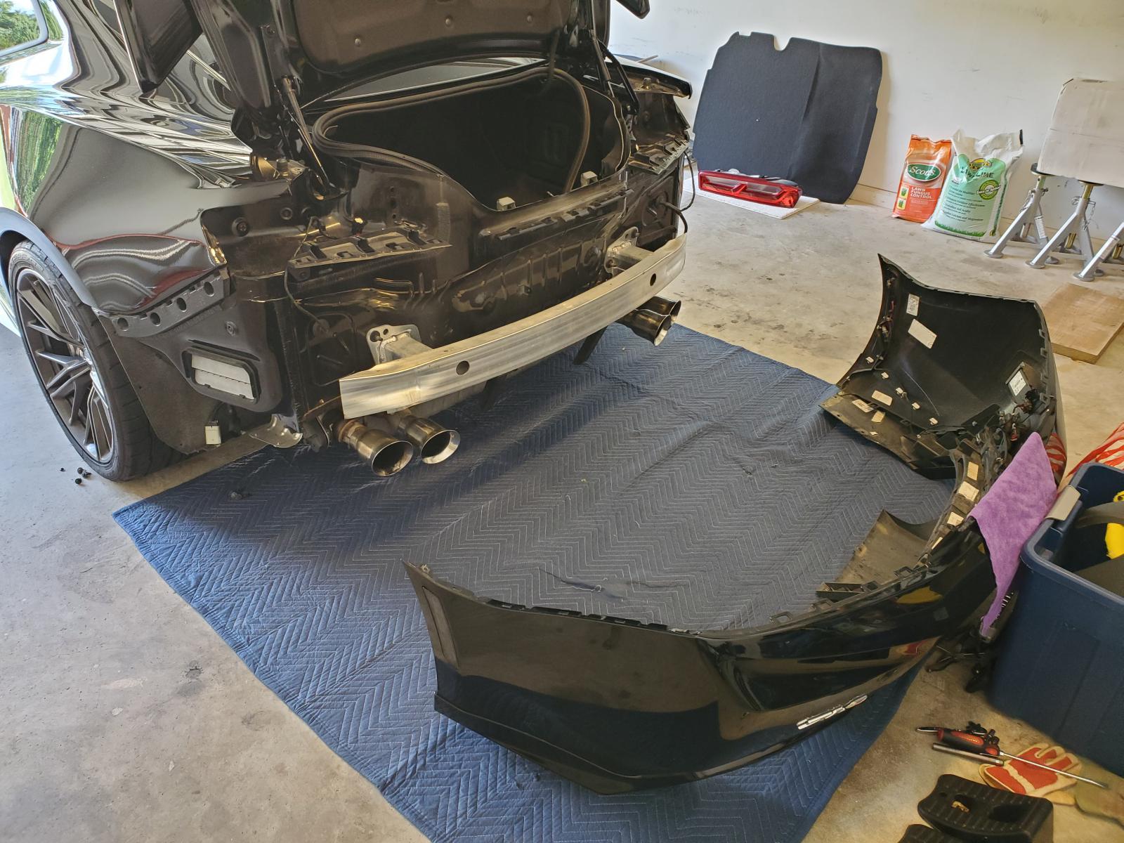

For what it's worth, moving the impact bar does the trick, as long as the plastic clips are still intact and not worn on all of the upper attachment points. Took me about 2 hours to fix it up properly per the TSB.

So are you seeing no heat expansion in the gap now?

It still pokes out a bit in the 95-100deg weather right now if it sits in the sun for a while, but only maybe 1/16" or so, maximum. Prior to moving the crash bar, it was at least double or more than that when it was in the garage first thing in the morning. Now, it is flush in the garage in the morning, and maybe that 1/16" when I leave work in the afternoon.

...and it came back over time. So, today when I installed dark taillights, I added some zip ties. My new opinion is save yourself the hassle of the bumper removal and just zip tie the darn thing.

Every single camaro does this. Its damn near impossible to stop it. And when you zip tie the sides, then it just bows out in the middle. There is no stopping the bumper from expanding when the car is hot in the sun. Just leave it. My feeling is anything that is "normal" meaning every other car has, Im not going to stress over it. Just leave it alone.

...aaaand I just found this out for myself. Once I parked it in the sun yesterday, the sides were great but the center had bowed out away from its attachment points and shoved up tight against the trunk. Soooo, this morning I pulled the taillights and got rid of the zip ties. Looks like I'm just going to live with 1/16 to 1/8 poke on each side when it gets hot. Centering the crash bar definitely made it better than it was beforehand though, so I'm glad I did that.
