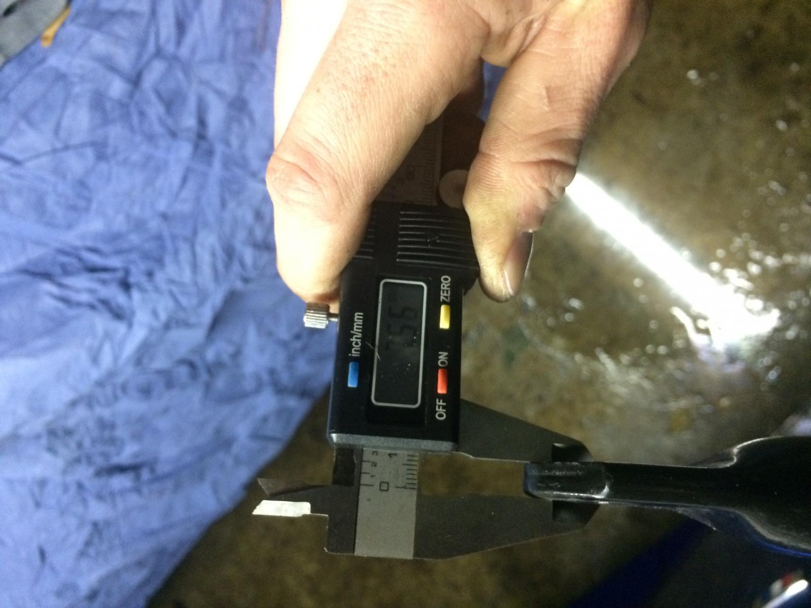

Powdercoating could account for most of that?

a small bump of the front bar (with other things constant) makes sense with the increase in tire...

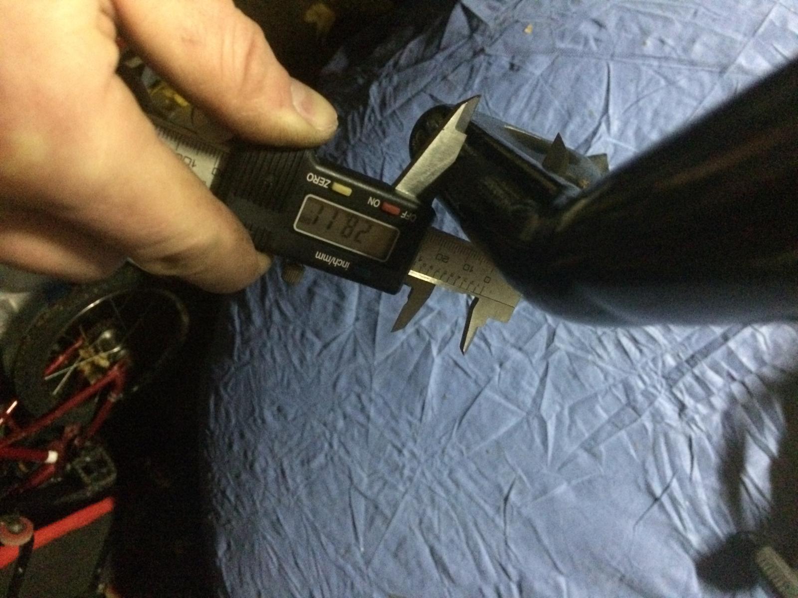

When others have measured the same way I have and got 28mm? I also measured multiple places along the bar and got 30.3mm everywhere.

Make sure that where you're measuring the bar is actually round. Tubing tends to go oval where it is bent - and for distances back along the nominally straight sections as well. The 'wider' direction of a bent tube is out of the plane of the bend, which is what the picture showing 30.37 mm looks like it's measuring.
Alternatively, measure in two locations spaced 90° around the circumference at each of your measuring points and consider the true diameter to be closer to some average.
I have no idea how thick powdercoating might be.
Norm
I did measure at multiple straight sections. The powder coat is chipped from shipping at a few spots. Using the depth gauge on the tail of the calipers, I get about 0.18-0.20mm thick. I also re-measured the bar diameter multiple places, on all straight sections, away from bends. This time I did an "out-of-round" type measurement about the circumference of the sections - every measurement is 30.36-30.37mm. The bar is 30mm. End of story.

A small update on my side. Keep in mind that I've ONLY installed the front bar. Took the car out today and the car feels much more neutral. Other than this bar, the car is stock with something like -1.5 degrees of camber up front. Ride is maybe a smidge stuffer over bumps. Honestly, I don't really notice much change in ride quality. More driving to come.
Also, measured the stock SS front bar exactly like I did the 1LE/ZL1 bar. It is 28mm. The wall thickness seems less than the 1LE/ZL1.
