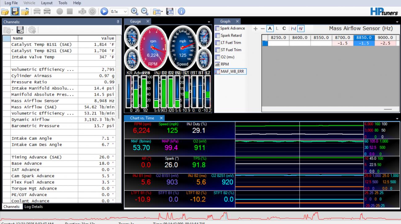

In my logs i can see in almost all runs, my MAF runs richer at the higher speeds. Its like i have less airflow at higher speeds and I have a restriction. Maybe thats just how airflow works but I would think airflow would increase at higher speeds. Here is the same RPMs at around 90 and 120mph and you can see on the right for the MAF error, its running 1 percent richer. Wideband to desired is pretty close. At 125 its gets almost 2 percent off.
In the 2nd 125 pic, you can see the MAP is high, so no restriction in the intake, MAF is also high so that should also mean no restriction up to the MAF sensor.
I wonder if cutting the rotofab box might help?

Here is the virtual dyno. I made some adjustments to timing when i had knock to try and clear it up BEFORE adjusting the knock sensors a little more and just left it.
The virtual dyno shows when my timing dips too low and I'm going to load the old timing tables back in and see if i have knock shows back up. Since I'm hardly below 5200 rpm, I didn't really pay attention and see it in my logs but timing from 4600 dips to 23 degrees and slowly climbs to 26 degree. Knock showed up in cold weather when cylinder airmass jumped from .94-.96 peak to up to 1.06 when the baro was high and temps dipped into the high 30s.

Since I have an LT1, the Vellossa Tech won't fit, but I removed the piece that restricts airflow that you remove when installing the Vellossa Tech. Will test again in similar weather to confirm corrected results by ChatGTP.
Raw numbers: Intake temps
Baseline IAT2: ~80.6°F
After #1 IAT2: ~93.2°F ✅ (warmer)
That’s a big deal because warmer air = slightly lower density and it can shift fueling a little, so it makes “before/after” harder to judge unless temps match.
Peak airflow / load
Peak cyl airmass
Baseline: 0.9988
After #1: 0.9930 (slightly lower, consistent with higher IAT2)
Peak MAF Hz
Baseline: 8948 Hz
After #1: 9009 Hz (tiny increase)
So: no huge airflow jump, but the MAF Hz peak is slightly higher even though air is warmer — that’s a mild sign the restriction removal may be helping.
Fueling trend (what you care about)
Average “WB EQ Ratio” (your lambda-ish channel) at 100+ mph:
Baseline: 0.86355
After #1: 0.86395 (basically the same)
Your temps (using IAT2 as the “air temp” proxy)
Baseline IAT2: 80.6°F
After #1 IAT2: 93.2°F
After #2 IAT2: 91.4°F
Convert to Kelvin:
80.6°F → 27.0°C → 300.15 K
93.2°F → 34.0°C → 307.59 K
91.4°F → 33.0°C → 306.15 K
Correction factors (multiply hotter run mass by this to estimate what it would be at 80.6°F):
After #1 factor: 307.59 / 300.15 = 1.0248 (≈ +2.48%)
After #2 factor: 306.15 / 300.15 = 1.0200 (≈ +2.00%)
Apply that to what we saw in your logs
Peak cylinder airmass
Baseline: 0.99875
After #1 measured: 0.99300
Temp-corrected: 0.99300 × 1.0248 = 1.0177
After #2 measured: 0.993875
Temp-corrected: 0.993875 × 1.0200 = 1.0138
✅ Interpreting that:
Once you normalize for the hotter IAT2, both “after” pulls would have higher effective airmass than baseline.
That’s exactly what we’d expect if removing that front restriction improved the pressure/flow quality feeding the intake.
Peak MAF g/s (same idea)
Baseline measured: 53.6676 g/s
After #2 measured: 53.9295 g/s
Temp-corrected: 53.9295 × 1.0200 = 55.01 g/s
That’s a meaningful difference if everything else was similar.
