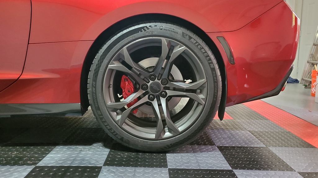

Originally Posted by SATINSTEEL1LE View Post
Yeah the 305/35/20's look too bulky on the back. I'd want the factory size of 305/30/20.
Depends on the tire, too, I don't think this is bulky at all
Agreed. I like the way the 35 fills the wheel well. Meh, to each their own...

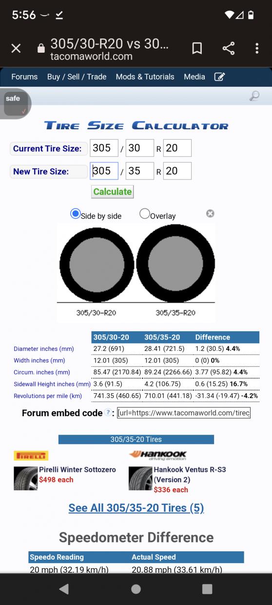

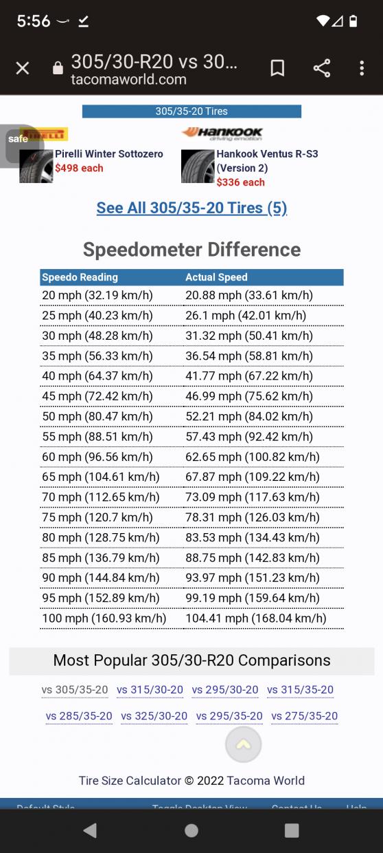

Does or did it throw any codes with the 1.2 inch difference in Diameter. . The speed difference at 50 MPH is 2.21 MPH 4.41 at 100mph. Thanks
I changed the fronts to 285/35/20 as well, so they're balanced out on my car.
That said, this is not an optimal setup as it's much taller than stock overall. I got them with the wheels in a great package deal and next time I need new tires I'll probably go back to a 30 aspect ratio. Just wanted to respond to the "bulky" comment.
