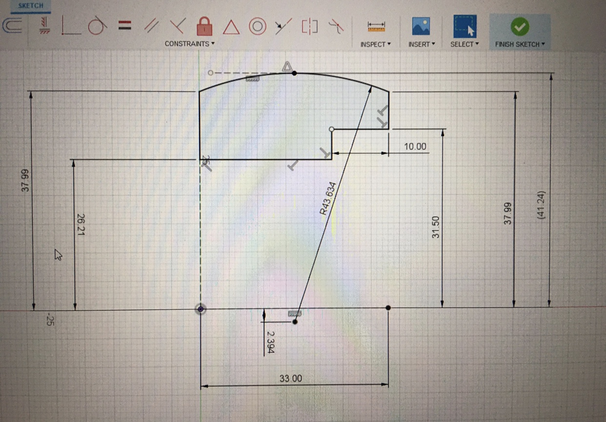

Originally Posted by RotoRocker View Post
Where were you able to source the A/C vent pod with the idash gauge? I keep seeing other combos like P3 gauge in that pod, or aeroforce top vent gauge/pod
Long story on the pod so this is the results of my research. I bought a couple of these pods from various sources. After not getting the results I needed, I created a solid model using Fusion 360. Saved the model as a STL file, and sliced it in Cura. First print was done with PLA and it deformed because of the heat. Second print was done with ABS and it works fine now.
I also printed one like SMG sells using a STL I found on Thingiverse and that wasn’t close to working because it was a sloppy fit.
Here’s some threads on the pod. First link is a pod I purchased the was for an AEM and not iDash. Second link is for the pod I made. I’m also including the dimensions for the one I printed.
https://www.camaro6.com/forums/showthread.php?t=572944
https://www.camaro6.com/forums/showt...php?p=10824702
Do you have a 3D printer?
