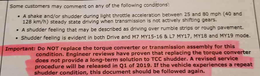

If this is the case, GM just told all that have had the TC replaced your vehicle is not fixed. I think this is telling! (they are now out of the costly TC replacement business!)
The other terminology that stands out is a revised "service" procedure will be released.
Sounds like another new magic fluid and possibly shift tuning.

Originally Posted by Klayman View Post
Attachment 966211
Shit. This does not seem promising.
My opinion, the upcoming fix will be a tune and fluid flush, or a combination of that and new pendulum torque converter, which is used in recently released GM 8 speed trucks.
