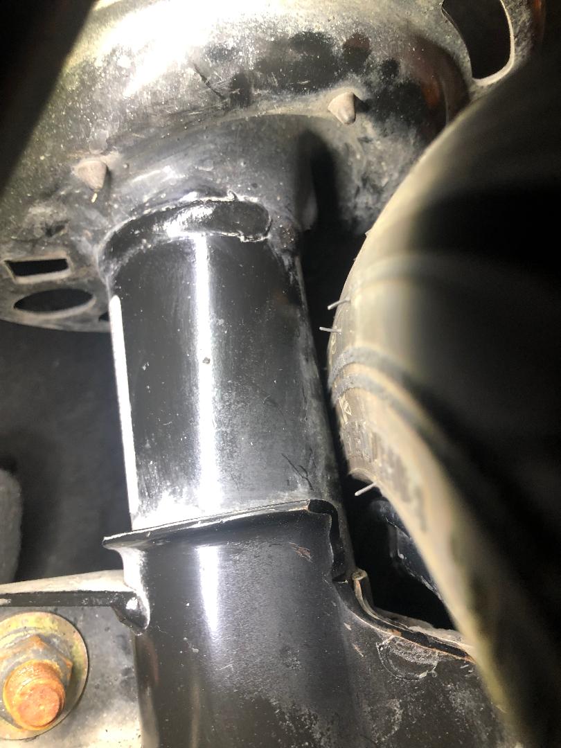

Tire Clearance with 8MM spacers
OK well the pics below are what the tire clearance looks like when using 8MM spacer. It PROBABLY is a little more than an 1/8 of an inch clearance. IF RT660's came in a 305 30 18 size I would go with that and the 5MM spacer but since they DONT, this will work.
The tire is basically EVEN with the top of the fender (in regards to TIRE POKE) so unless you want to push the tires OUT of the wheel well, this is the MAX size tire (315 30 18) you can run on a 18 x 11 ET25 wheel on the FRONT of the car. The centering ring that is on the HUB will still be able to go thru the spacers and engage in the hub of the wheel. A 10MM spacer is TOO thick to allow this and that is why you CANT use a 10MM FLAT spacer (if you could find one). Those type of spacers (generally 10MM and thicker) that have the centering rings by the way are HEAVY. They are roughly 3 pounds a piece because you bolt the spacer directly to the hub and in turn bolt the wheels to the studs that the spacer has on it. Avoid them if possible.
Now a ZL1 will have a little more room under the front fenders vs a NON-ZL1.
Notice also that if the tire was MUCH taller then it would rub at the TOP of the tire on the spring perch. My guess would be that 19 inch wheels WOULD NOT work with this combination and I even have my doubts that a 35 series tire on an 18 inch rim would work due to its increased overall diameter as well.
LME 416 engine will be delivered tomorrow and in the meantime I ordered some ZL1 type side skirts to TRY and keep the stone bruises off that area just in front on the back wheels. I have a GREAT guy I use that is going to WRAP that area with a gloss black wrap and THEN is going to put protection film over it. My Theory is the side skirts should to a certain extent keep flying debris from coming off the track surface and then DIRECTLY hitting that area. Typically this wont happen with street tires but anything 200TW and softer will have a tendency to pick up debris especially when the tires get hot.
Something to note here also is that the AMOUNT of NEGATIVE camber has NO effect on these clearances. The reason for this is just the TOP of the strut assembly moves with camber changes using in my case VORSHLAG camber plates. I am running roughly -3.7 degrees camber but if I was running say -2.0 degrees camber the TOP of the strut assembly would be closer to the outside of the wheelwell and in THIS case I would have some tire poke on the top of the tire outside the wheel well. So camber changes can DIRECTLY affect tire poke but NOT the inner clearances.

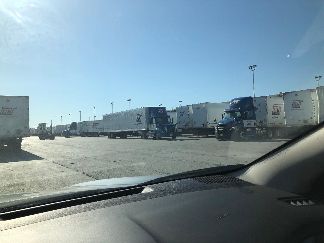

Well the 416 arrived actually on monday but AAA Cooper Transportation who was handling the delivery to AMP has not gotten off their asses yet to get it over to AMP. That should happen today.
I was curious about that so I made a trip to their AAA Cooper truck terminal and found a freight terminal that had over a HUNDRED loading docks almost ALL being used and maybe another 500-600 trailers that apparently HAVENT been unloaded yet. Looking INSIDE the loading dock area and all you could see were pallets of unloaded freight There are literally HUNDREDS of people it seems working inside this terminal.
So basically if you look up the words CLUSTER *UCK in the dictionary, you are going to see a picture of this freight terminal. I know we all have seen articles about the challenges of getting freight delivered and unloaded in a timely manner but to see it in person is pretty eye opening.
