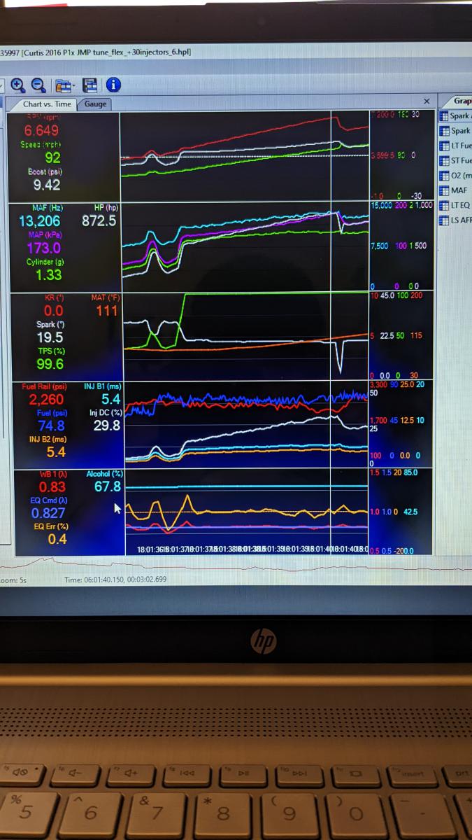

We upgraded fuel system on P1x car today to FIC +30 with LPE pump. Got up to E68-70 @ .83 afr target. High side just starts to drop a touch up top, plenty of injector left. SOI 361, EOI 150. Looks like it gained a decent amount of power from the last log but it was hotter out and pulling timing. I don't use the HP calculator PID as a end all be all...just there to compare changes similar to a Dyno. Went from 805hp to 872hp. Again that doesn't mean I think it makes 872 bhp. There are things that can manipulate the numbers such as VTT but once you have it all set up it can be used to verify changes. It gained about 7hp from E55 to 68.
Old 08-14-2022, 07:17 PM   #50
LT1ornothing
Drives: 2020 LT1 M6
Posts: 1,114
As you have been saying all along, 90% of the gains of e85 are realized by e50-e55. Great stuff man.
