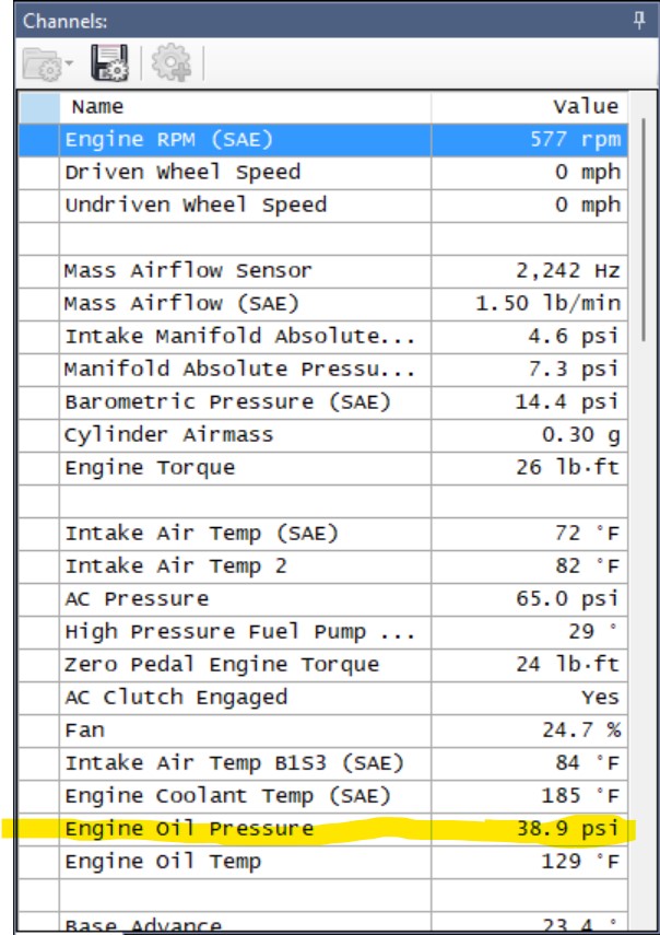

Old 03-30-2023, 07:09 PM   #48
2023_ZL1-AUTO
2023_ZL1-AUTO's Avatar
Drives: 2023 ZL1
Join Date: Dec 2022
Location: Columbus, Ohio
Posts: 1,287
Mine is 38.9

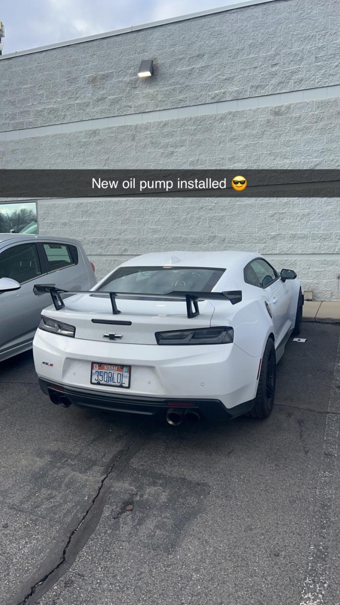

Peep the 30 PSI at operating temp now!
SammYyYyY is offline   Reply With Quote

Originally Posted by SammYyYyY View Post
It seriously does have to be the fastest ever. I dropped my car off on Monday, and now it's sitting in my driveway in time for Cars and Coffee tomorrow morning. Unreal service.
I'm not even mad about them not asking tbh, I expressed my concerns and how I suspected it was the pump, and if I can get it done under warranty to just do it, so I'm totally good with it. My face lit up at work when I made the call and they were like "oh yeah it's literally being worked on rn." lmaooo
Attachment 1123995
Attachment 1123996
Very happy for you. Did they say if the oil pump had a break or start of break? I think I will follow your lead if I see it below 29-31 where I see it warm. I appreciate how you kept the community informed. Thank you.
