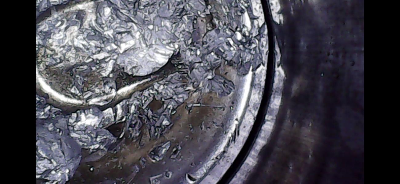

Friday I was pushing my car pretty hard and something internal let go. I made 15 runs in 3 hours on a warm day(85deg, 3200 da), I was working on my 60’ but also turning up the boost in the higher mph’s. Ended up running 6.00 letting off early with a less than stellar 1.46 60’. May have been a new best if it hadn’t broken.
Logs looked mostly good. A/f, fuel pressure, timing, boost all where I wanted them. After looking closer I see my coolant temp was pretty warm pre run. 220deg. Might have helped to give it a little more time between runs.
From what I can see without taking the motor apart I think I may have dropped a valve or had one seize and get hit. The piston is still attached to the rod and does not look to be broken. I will have it apart in a few days and know more.
Thinking I need a used motor and then swap as much as I can over. Buy one new piston, new rings, put some better valves and maybe guides in the heads. Might do main studs this time.

Hey that almost happened to me, valve nicked the piston but mine was minimal damage with just a bent valve and cleaned up the nick on the piston. Put it back together and mine happened after 4 back to back runs without lifting the hood on a 90 degree day. Plus I think the rev limiter was a bit high and may have over revved as I had someone else do the initial tune and I guess he changed the rev limiter and we weren't aware of it so it kept spinning the tires badly in roll racing and shit happens after 4 runs in a row it was floating the exhaust valve as all the seals were beat down or completely torn off. Sorry to hear that and hope you get it up and running before the end of the season. Hopefully nothing else happened

Yep, dropped a valve. The spring, retainer and locks are all still in place. Not sure if it stuck and then got broke off or if the head just fell off. This isn’t an area I was really worried about.
I doubt I will get lucky but I am hoping the cylinder isn’t destroyed.

I'd check for telltale contact marks in the valve relief area on all the other 7 pistons.
My tuner is saying that the ramp profile of my cam is partially responsible for my lifter failure. Whatever cam I'm going to, it will have less lift, and a smoother ramp, especially on the deceleration.
Last you can check the comp cams conical spring white paper and note that dual springs can have some funky oscillation leading to very low spring pressure at certain harmonics and high lifts. The problem I have with the conical springs is all of them have some serious lbs / inch. I don't know if I want to run that on a street car. Don't see any problem in a race car.
I'd look at this cam:http://www.cammotion.com/gen-5-lt-ca...-5-vvt-delete/
and spec at .600 to .612 lift. Supposedly cam motion and BTR have better valvetrain stability in their profile
Texas Speed does have a good price on a darton sleeved short block. I think Pray is a vendor. They are just north of Austin.
