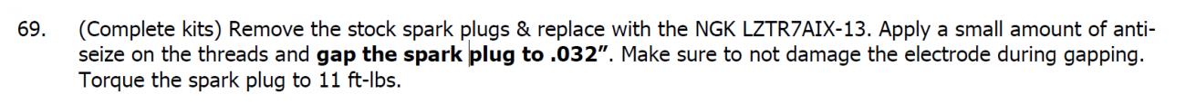

Nope I just confirmed straight out of the manual. It's the ONLY reference to NGK in the whole PDF:
69. (Complete kits) Remove the stock spark plugs & replace with the NGK LZTR7AIX-13. Apply a small amount of anti-seize on the threads and gap the spark plug to .032”. Make sure to not damage the electrode during gapping. Torque the spark plug to 11 ft-lbs.
