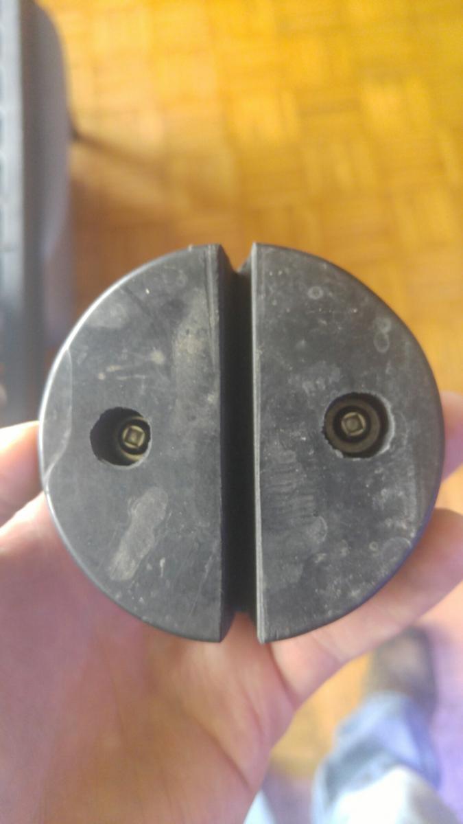

Here are some up close pics of the jack pucks I made. Nothing fancy, just used common hand tools to construct (cordless drill, hacksaw, razor blade).
You can see the taper I cut for the pinch seam itself, this allows it to stay suspended while you position the jack. The seam was tall enough that I had to basically cut all the way through the puck to fully support it. This required the second puck for obvious reasons, the added bonus of giving the jack 'cup' some added clearance to the rocker.
They were a little rushed and could be nicer, but hey, they've worked beautifully so far... and cheap as dirt
