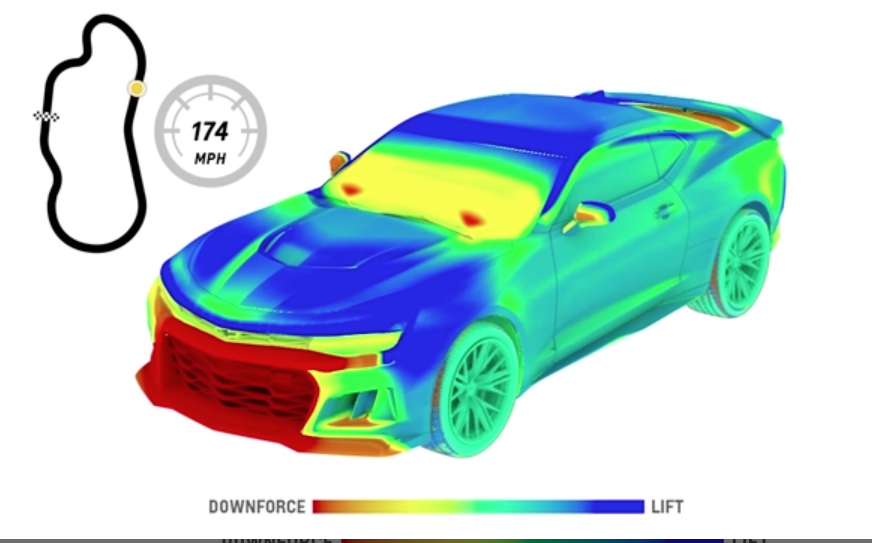

This video has probably been on the ZL1 overview page for a while, but I just viewed it for the first time. While the color isn't solid blue all the way to the lift side, I didn't see the colors I expected to see on the spoiler with the various engineering and downforce comments.

I think it's partly because you're looking just at the top of the wing. If you look at the trunk lid, you'll see downforce pick up as the speed climbs. There is also going to be air pulling down on the bottom of the wing as the air passes under it and falls off the trunk lid. You're going to have more pull from under the wing than anything due to the wing being slightly tilted nose down, creating a vacuum under it as it flows through the air. It's this vacuum under the wing pulling air down onto the trunk lid, which is a flat surface, and the air sucking down on the bottom of the wing, that creates downforce with very little drag. A spoiler creates downforce by packing air onto it's steeply angled face, which adds about as much drag as it does downforce.
That's pretty enlightening. Thank you.
