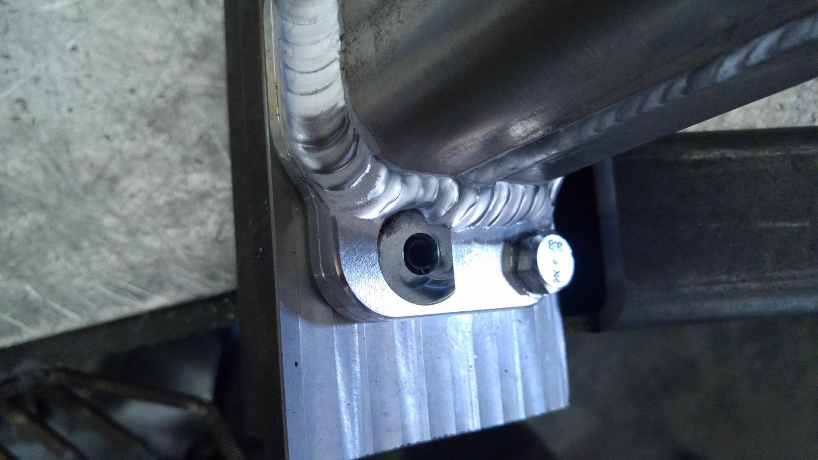

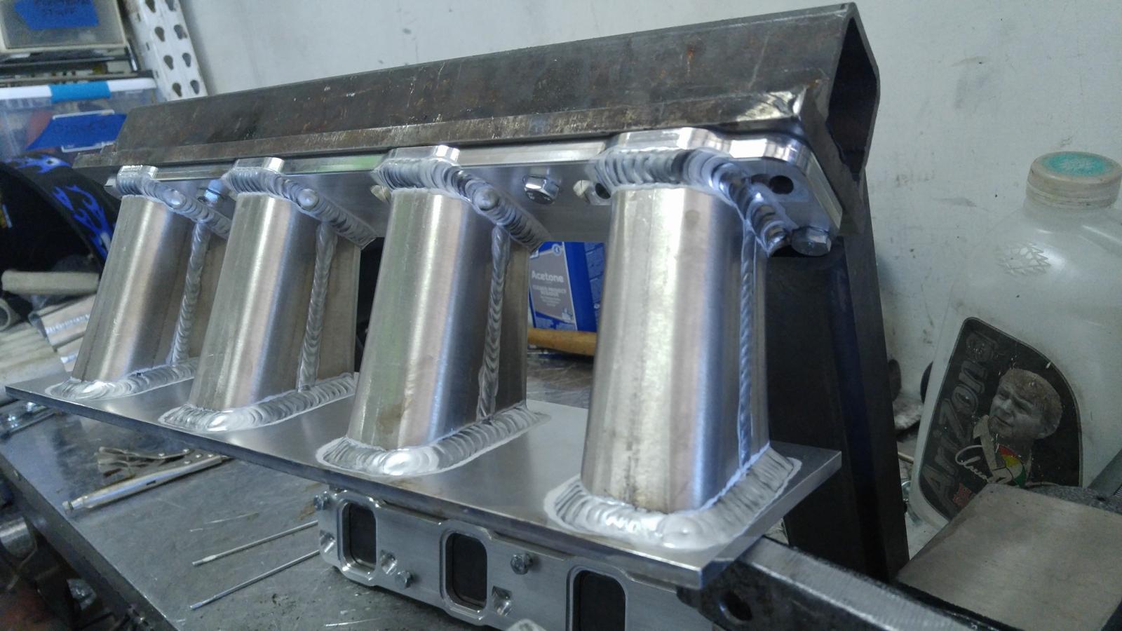

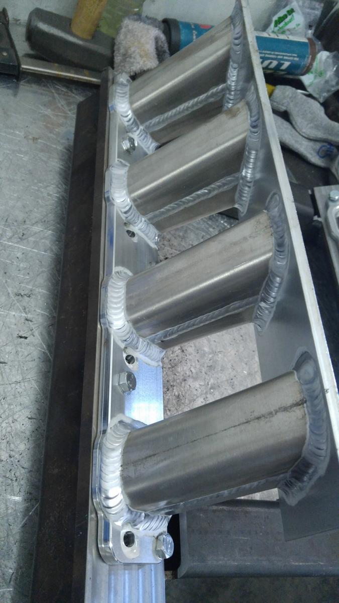

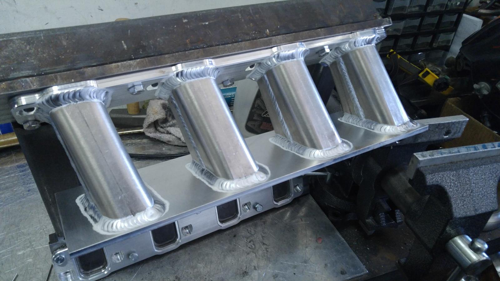

Posts: 530

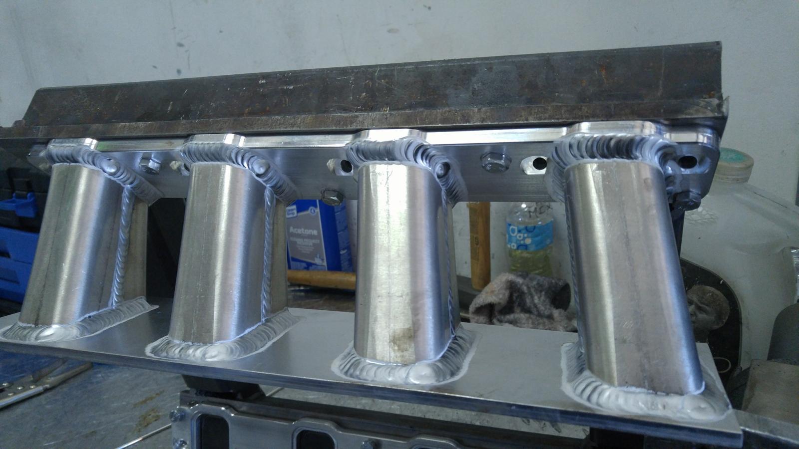

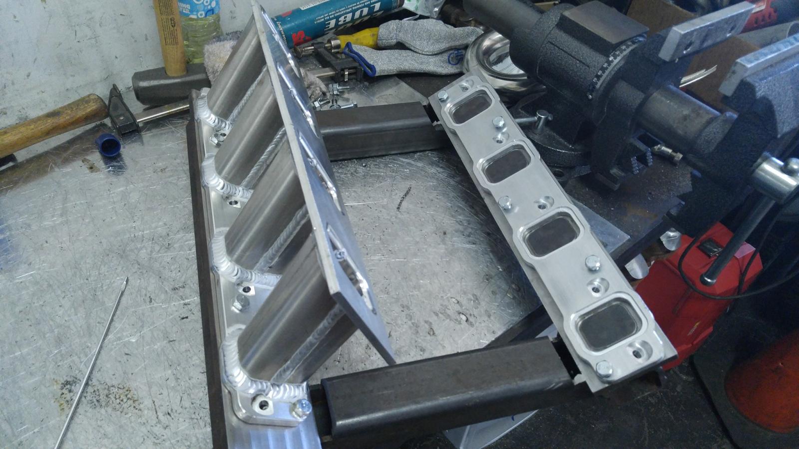

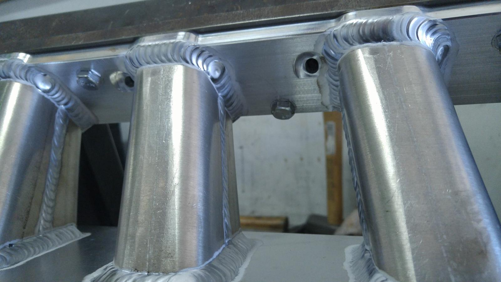

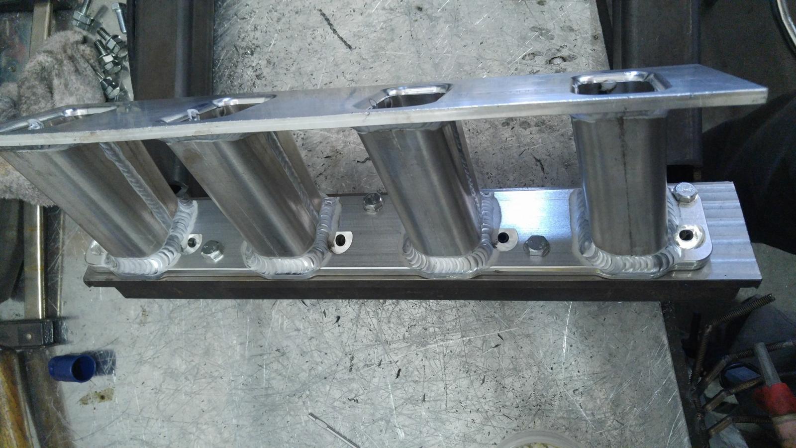

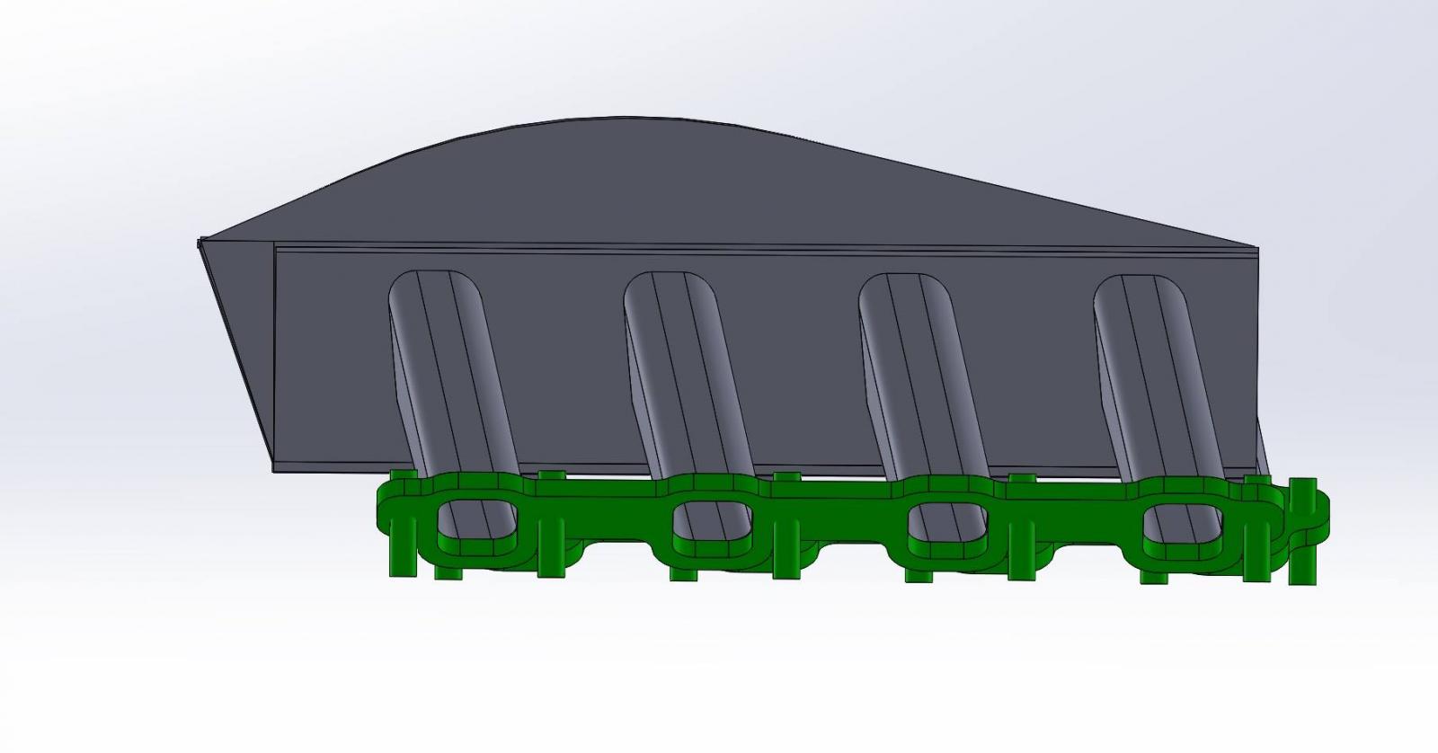

building a new batch of intake manis this weekend.
Made some drastic improvements to the fixture, and new fixture location bolt holes on the flanges that will compensate for shrinkage during final weldment. Also the new runners are a near perfect fitment so I won't have to make such a long dirty mess at porting.

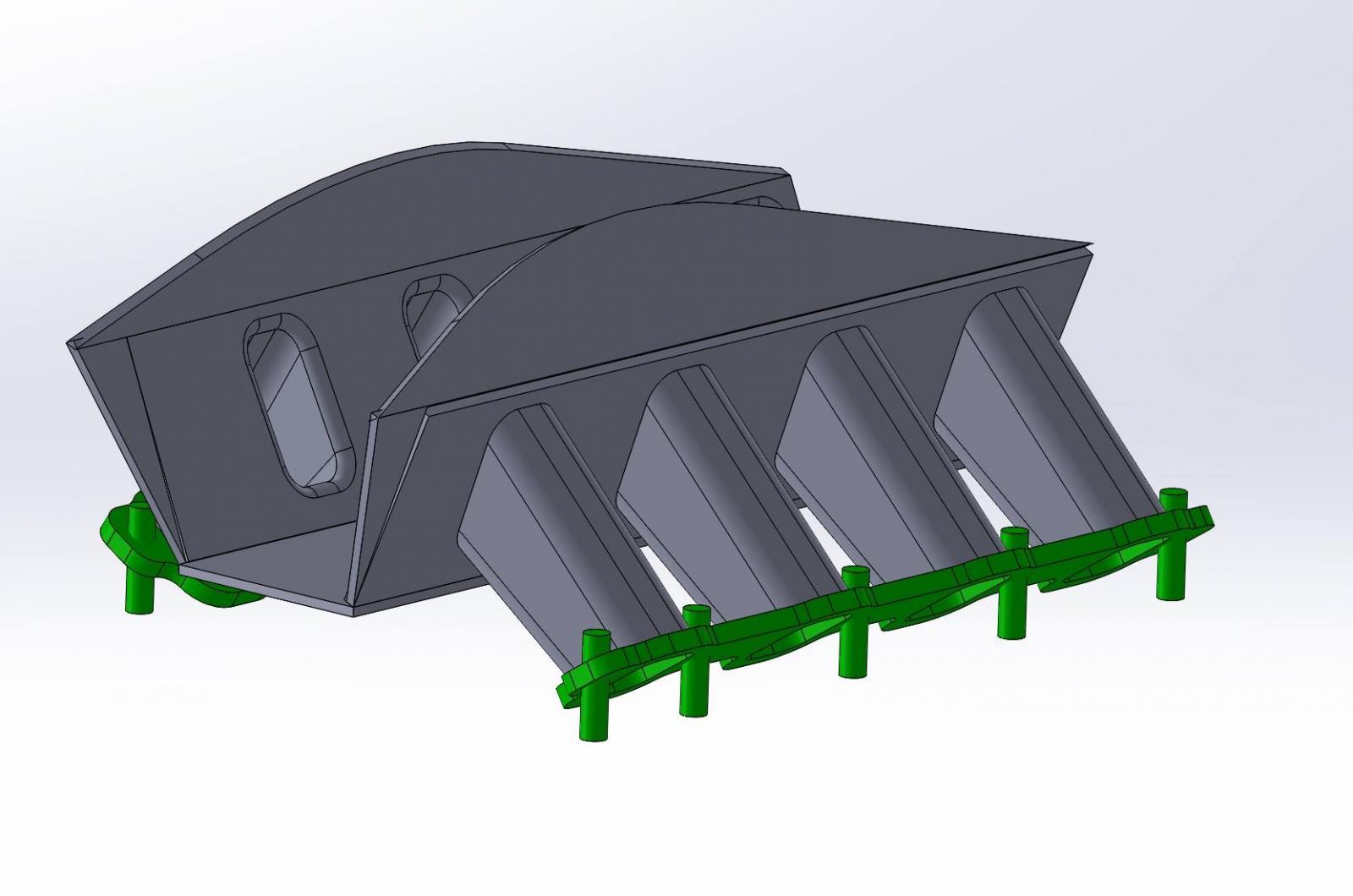

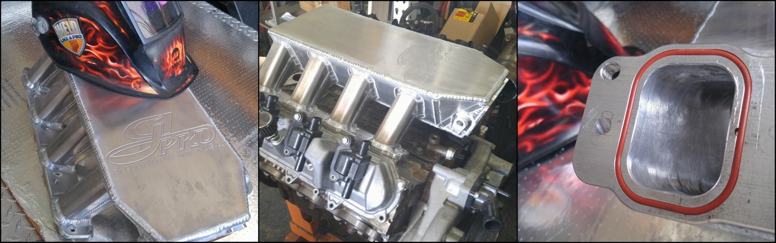

Posts: 530

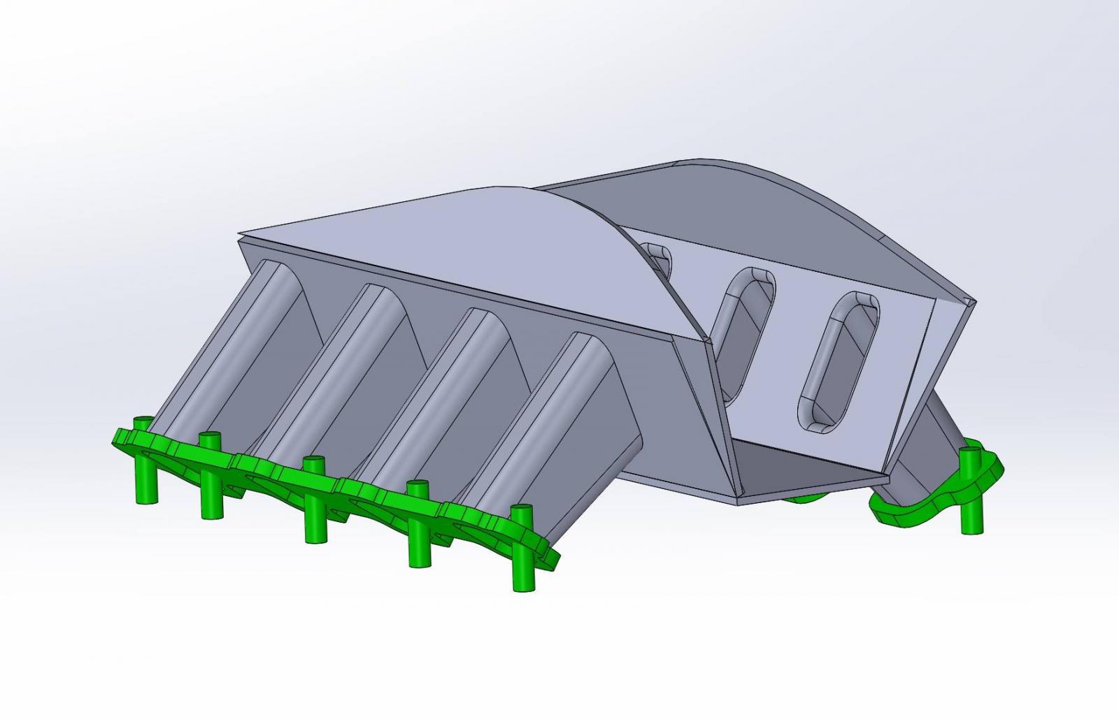

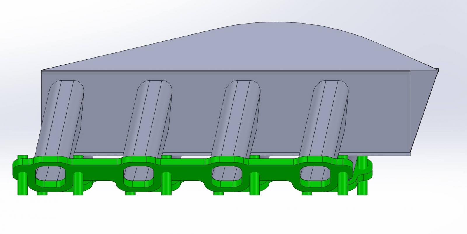

Bigger Badder Race Version LT1 Intake Manifold Designs in route. Camleback design gives even greater plenum volume. Should still fit under a C7 Hoodline
