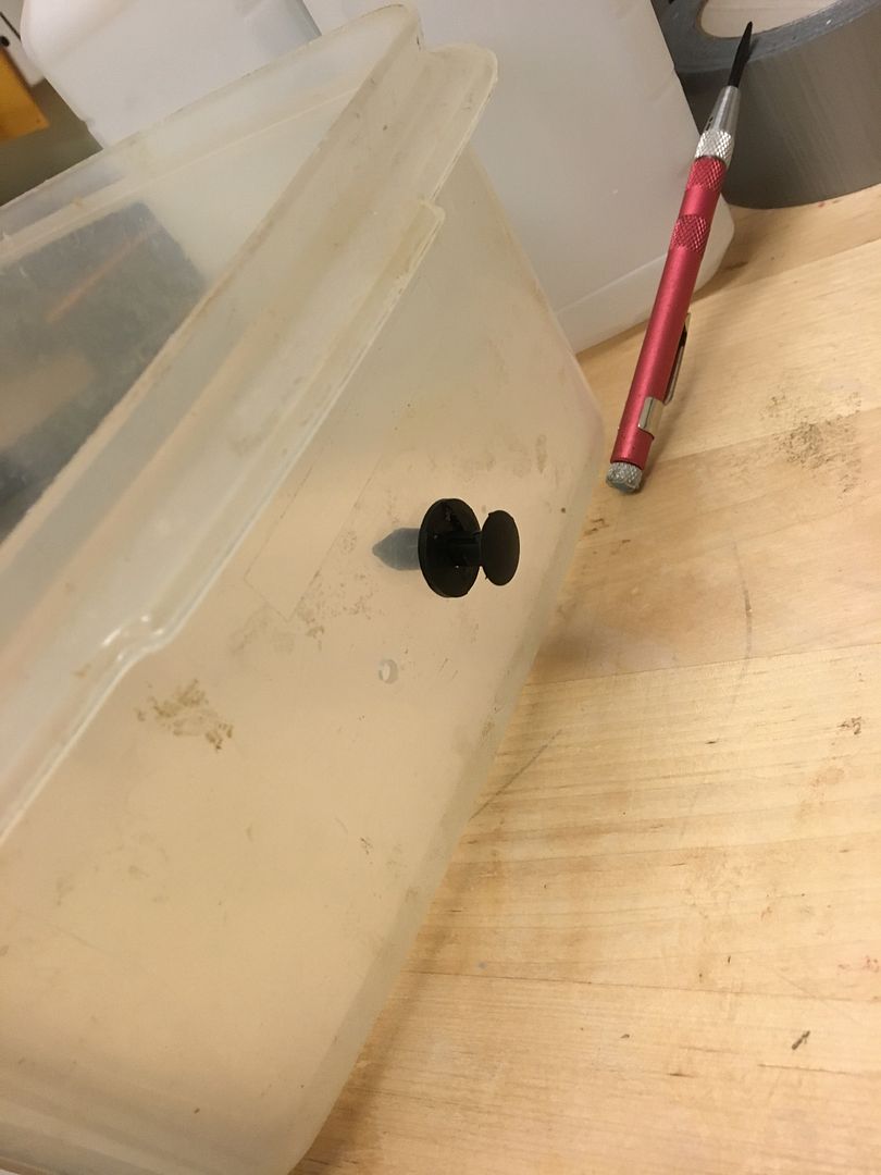

Dunno....get some Tupperware. Get some drillbits. Drill what you think the size of the Popper. Put the popper in. Pop it. Now you know what size to use. You don't hit anything when you break through the bumper.
